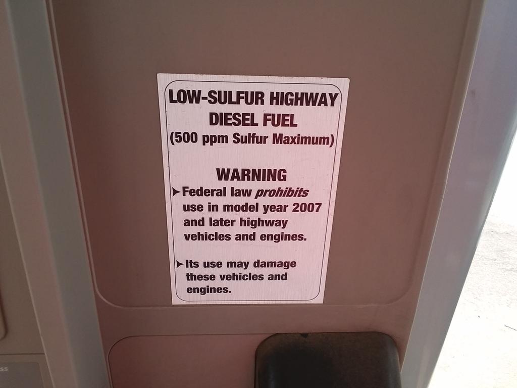

as for adding a lubricity agent I've read that none is better than BIO DIESEL which is automatically added as a Government rule, I could be wrong but I don't know of any fuel pump that dispenses straight ULSD WITHOUT bio. Im fortunate enough to be able to get it from a pump at the loading rack BEFORE the Bio additized fuel is loaded into trucks for distribution.
I only know of a few stations that dispense diesel with biodiesel already added and those stations are typically Sinclair branded.
I add the biodiesel to my storage tank before it goes into my vehicles.[/QUOTE
B2/B5 is not required by federal law to be posted at the pump. Most have at a minimum B2 with B5 becoming more and more popular. Just because it is not posted does not mean your not getting it.
