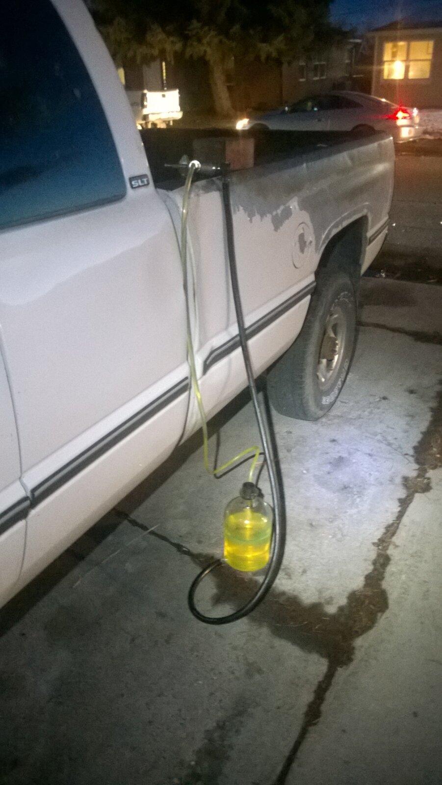

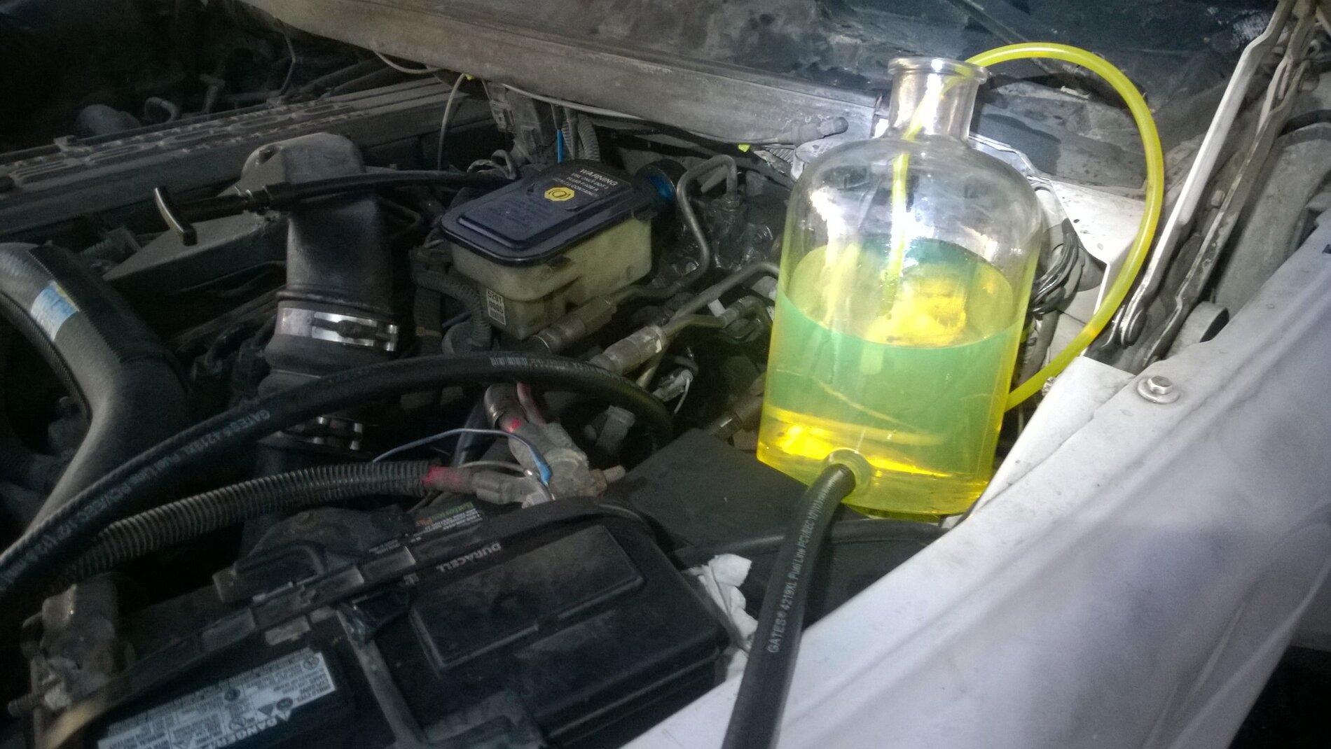

I dropped the fuel tank and pressurized the fuel lines under the truck and in the sender and found no signs of a leak. My next test I thought would be pretty bullet proof. I got a jug with a tap at the bottom and ran fuel directly from the jug to the lift pump right under the hood. I put the return line right back into the jug with some clear hose and found aeration! I drove around a little like this and I always had air bubbles in the return. I did some research and found that some Cummins branded lift pump were cheaply made and the DCFC china made one are preferred. The one on the truck is not DCFC branded, so may that's the issue. I pulled the pump and tried it on the bench. If I kinked down the large fuel hose I had going to the pump I could get air bubbles in the return. So I got a DCFC pump. After installing it I had 30 psi at idle until I drove it around for a bit it returned to 20 psi at idle. At higher power under any circumstances the pressure would drop to about 10psi.

Check out the pictures of most test tank.

I've by-passed everything up to the lift pump and used a new hose from an auxiliary tank as seen in the picture. This eliminates all old rubber hose and the pre-filter (which I changed 100 miles ago when eliminating the heater). The 90* fuel line is brand new at the same time as the pre-filter. Still direct to the lift pump by-passes that. At idle I get right around 20 psi. any amount of accelerator pedal drops it and even at a light cruise I get maybe 12 to 13 psi an not anything close to 20. I'll study that link about the fuel system. I've studied a lot of info so far, but I'm always picking up something new.

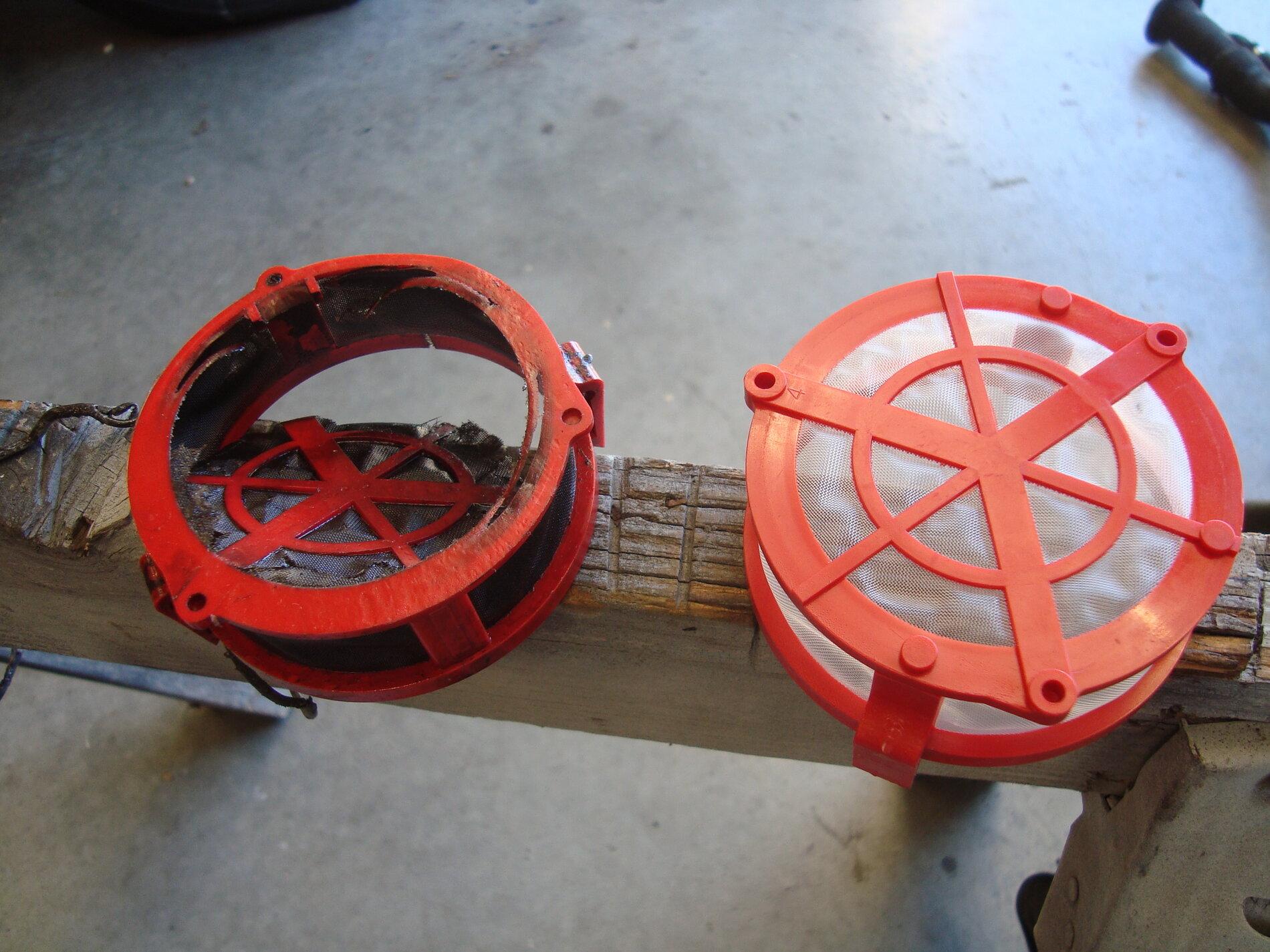

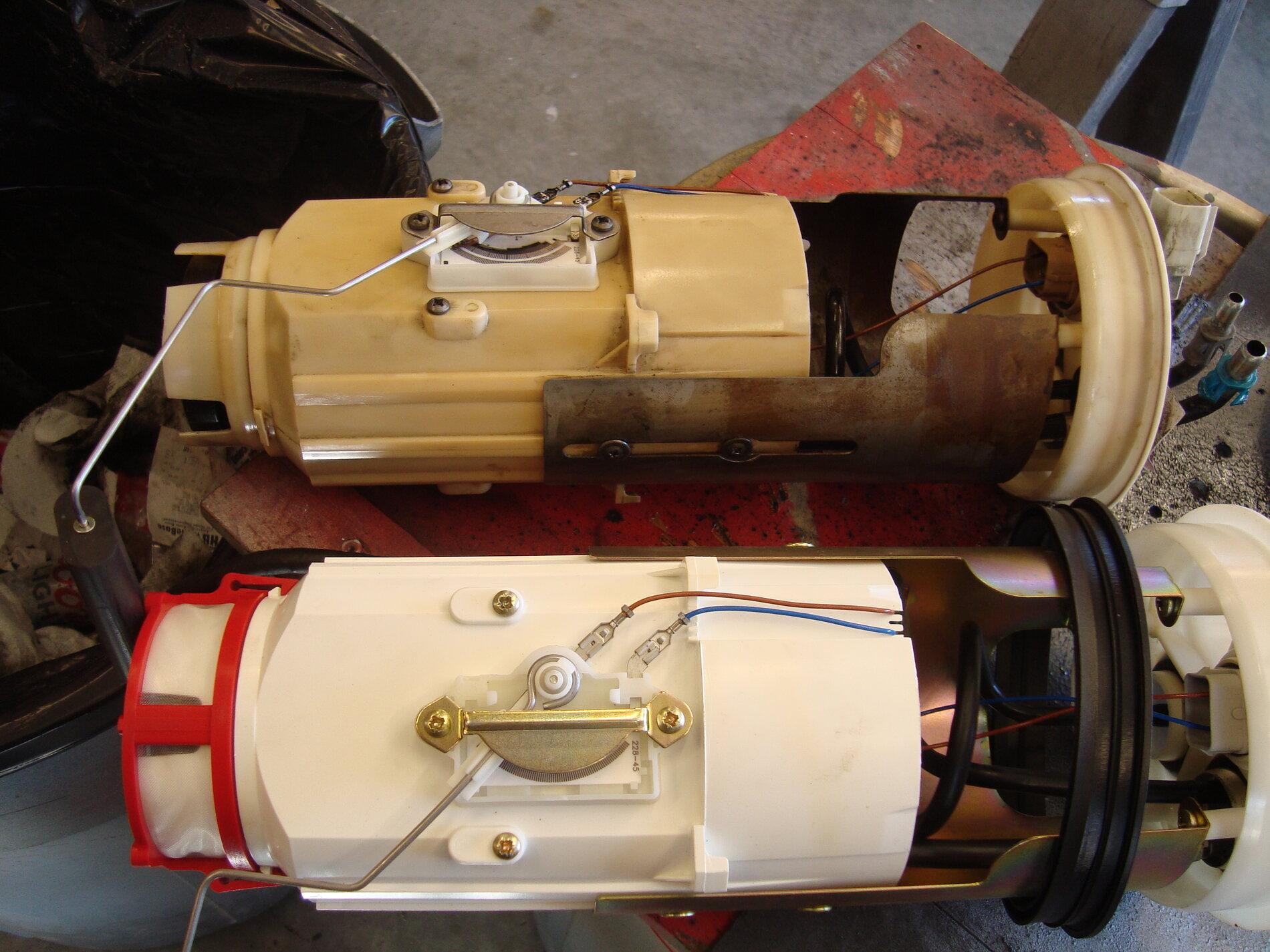

Although I get a slight drop when pulling trailers up steep hills my pressure never goes below my idle pressure, or get near it for that matter. When you dropped the tank did you remove the module and look inside? The module has a screen on the bottom that could be clogged as could the pickup tube. This is the old one and the new one I replaced it with last month. Notice the screen was completely worn through from rubbing on the bottom of the tank. I replaced it because my fuel gauge had become unreliable.
I've had that out just a few months ago. It was in really good shape. When my brother first bought the truck the fuel gauge didn't work. I fixed it by extracting the sender and cleaning the resistive swiper contacts. The whole thing had a dark film over it. I forgot about that. Just a shot of brake parts cleaner made it work again and in the past 7 or 8 years I've never had an issue. If I had junk in the filter, even if most of it has been removed, my filter may be partly plugged again. I might just swap it again to check the status.
