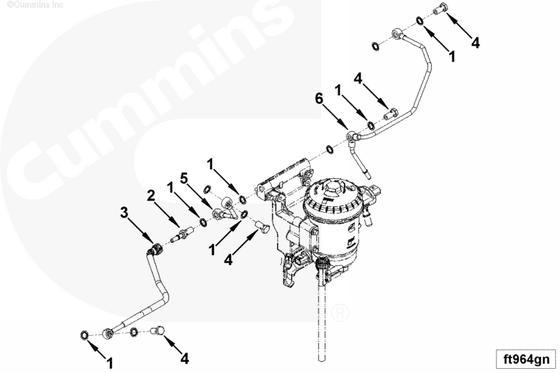

I've been trying to find it on QuickServe also, but the best I can do is find a pic of the plumbing to the filter head and not the filter head itself!! #@$%!

And remember that there are both front geartrain AND rear geartrain 6. 7 engines produced so that adds to the many options for lines and other hang on stuff.
