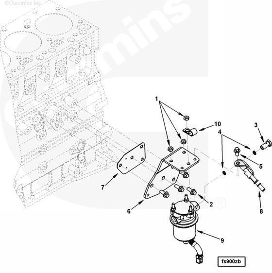

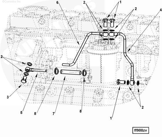

I think the connectors are Dodge but just to be sure I'm posting pics of the fuel filter and fuel pump plumbing.
If your fitting hooks to #8 in the lower picture then it is Dodge. Dorman offers repair ends for those. I will post a link to those shortly.
