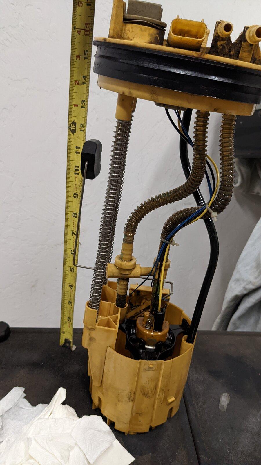

Also, now I understand why, when I fill it up, the fuel gauge stays on Full for quite a while, then drops pretty fast. Seems like the float for the sender is pretty generic, spring loaded and all.
The tank is 14 1/2 inches deep, and the float only goes up to about 3/4 of a tank before it's straight up.
The more I work on her, the less mystery there is!View attachment 132955
You are measuring the float with the pump "uncompressed". When you go to put it in the tank, you have to push down against the spring for a significant distance to get it seated in the tank, which will put the float up near the top.

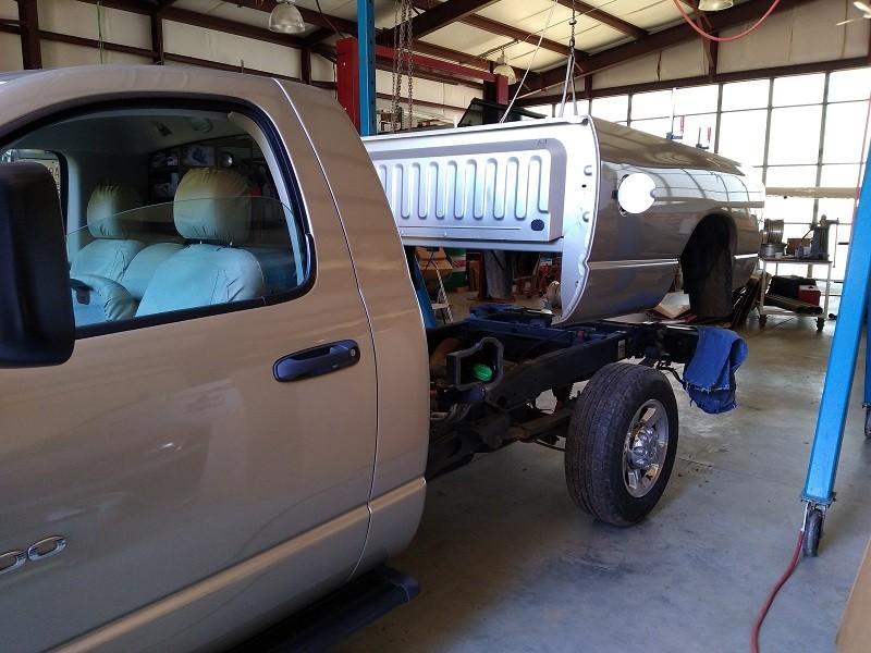

I speak from experience on a Mercedes Sprinter pump, similar design. I will find out probably tomorrow on my '03 5.9L HO as I am pulling the bed and installing the in tank pump conversion kit. Hope there is not a lot of crap in the tank, I have it down just below half, and don't intend to drain the tank to clean it out. Its easier for me to remove the bed (done it before and have a portable gantry crane and homemade wooden lifting fixture to go under the bed rails) than to drop the tank.

I'll pull the bed on a truck anyday, before pulling a tank. Used the two post lift and a couple of 10 ft 2x6's to lift the Leer topper off (its heavy (long bed) and then used the portable gantry crane and a lift fixture to pull the bed. Took me about 2 hrs. Its only 8 bolts, a bonding strap, the taillights and feed their harnesses out the bottom, the three screws on the fuel filler neck, and off it comes. I put cardboard up front to protect the cab, and old blue jeans draped over the ends of the bumper to protect the bed there.
I changed the rear shocks while I had it off. I had put Rancho 9000XL's on the front just a while back as I was not happy with the KYB mono max. With the bed off, I got to thinking how much easier it would be so I ordered the Ranchos and stuck them on. Big difference, will see what it does towing the travel trailer.

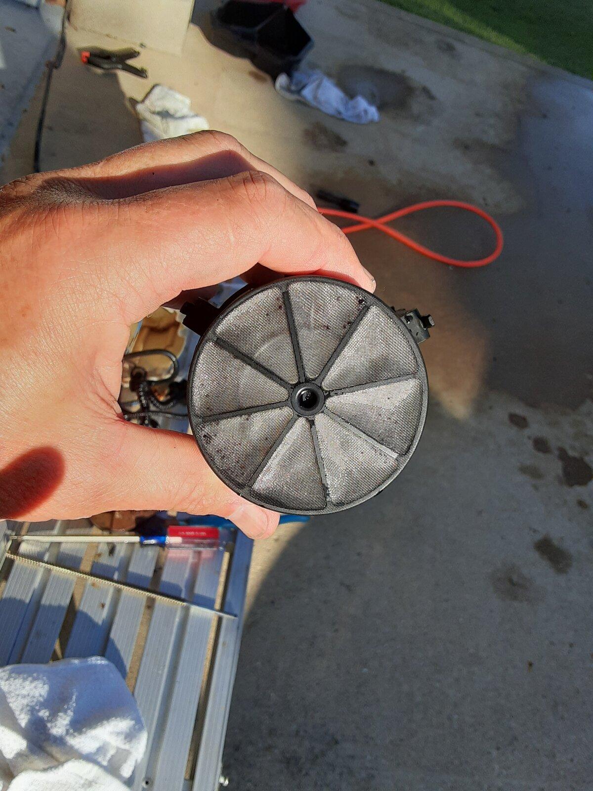

Is there a fine screen/ pre-filter on the bottom of the actual pump that sits in the bottom of the whole assembly? This is what the 2008 Sprinter diesel pump has (this pic is after I had disassembled and cleaned it) it was covered in 1 or 2mm of crud, I did clean it even more before reinstallation.

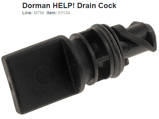

Essentially. As with all things nowdays, stuff is difficult to find and takes forever to get to you.
Well, too late this time, but O'Reilly's has them in stock for $7.50 next time you need one. We stock six at all times at the shop. They also fit our buses and most of our Dodge/Chrysler vehicles. We've never had a problem with the Dorman's. It's always just a cut o-ring.
Well, I prefer OEM stuff as the one that was in there was aftermarket (I put it in about 3 years ago) and the OEM is better quality plastic and seal. The one you show is the same one NAPA shows for Chrysler products (I bought one) but it DOES NOT fit (I tried while waiting on the real thing), and is not the correct drain. The correct drain looks like this..................
The pump has some kind of a sock screen on it, does it not? I replaced the pump in my 2007 Winnebago View (2006 Sprinter T1N 5 cyl chassis) because the quantity sending unit had failed and are not available as a spare, and I was preparing to sell it so it needed to work. Brand new Bosch pump, made in the Czech Republic just like the original and you could see where the mold was changed to blank out the MB logo and p/n. Same pump, just made for aftermarket. That was an easy tank to drop, only took a couple of hours. Spent more time cleaning the outside of it.
Charles
The 2008 did not have a sock of any kind in the pump assembly.
If you go through the effort to drop the tank of any vehicle with this type of in-tank pump and are not replacing the pump, I strongly advise that you carefully disassemble and clean thoroughly. If the inside of the tank is cruddy looking so is that screen/ pre-filter.
