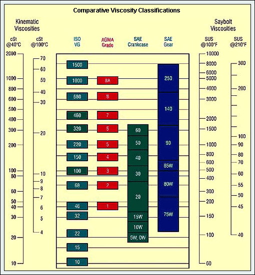

It's actually about the same thickness. 75w-140 is thinner when cold and thicker when warm than SAE50.
ATF also isn't nearly as thin as most people think. It's thinner for sure, but nothing crazy. At 40° C it's about the same as thick as a 75w gear lube and when warmed up it's about as thick as a 80wt gear lube, so it doesn't change much.
It's actually about the same thickness. 75w-140 is thinner when cold and thicker when warm than SAE50..

Yeah. I see your point. I used to think thicker was always better. And It's hard to change 40 years o f thinking. With these new oils that can withstand high temps, sometimes thinner can help it cool better and still lube adequately. I don't think I would go with straight 50 though.
That is correct, my trans runs hotter with the heavier 50wt oil than 50% Royal purple/50wt. The thicker the oil the harder for it to transfer the heat. That's one of many reasons for my cooler setup. For the G56's still running the DMF, you could practically pee into the trans, and its going to sound OK. The heavier oils should be used when the "pressure plate flywheel/G56" has been converted to the SMF. If your going to go heavier than OEM, add a temp sensor and know the difference in how hot it gets, you might just go back to ATF with a DMF, because it'll run cooler and still be quiet.
