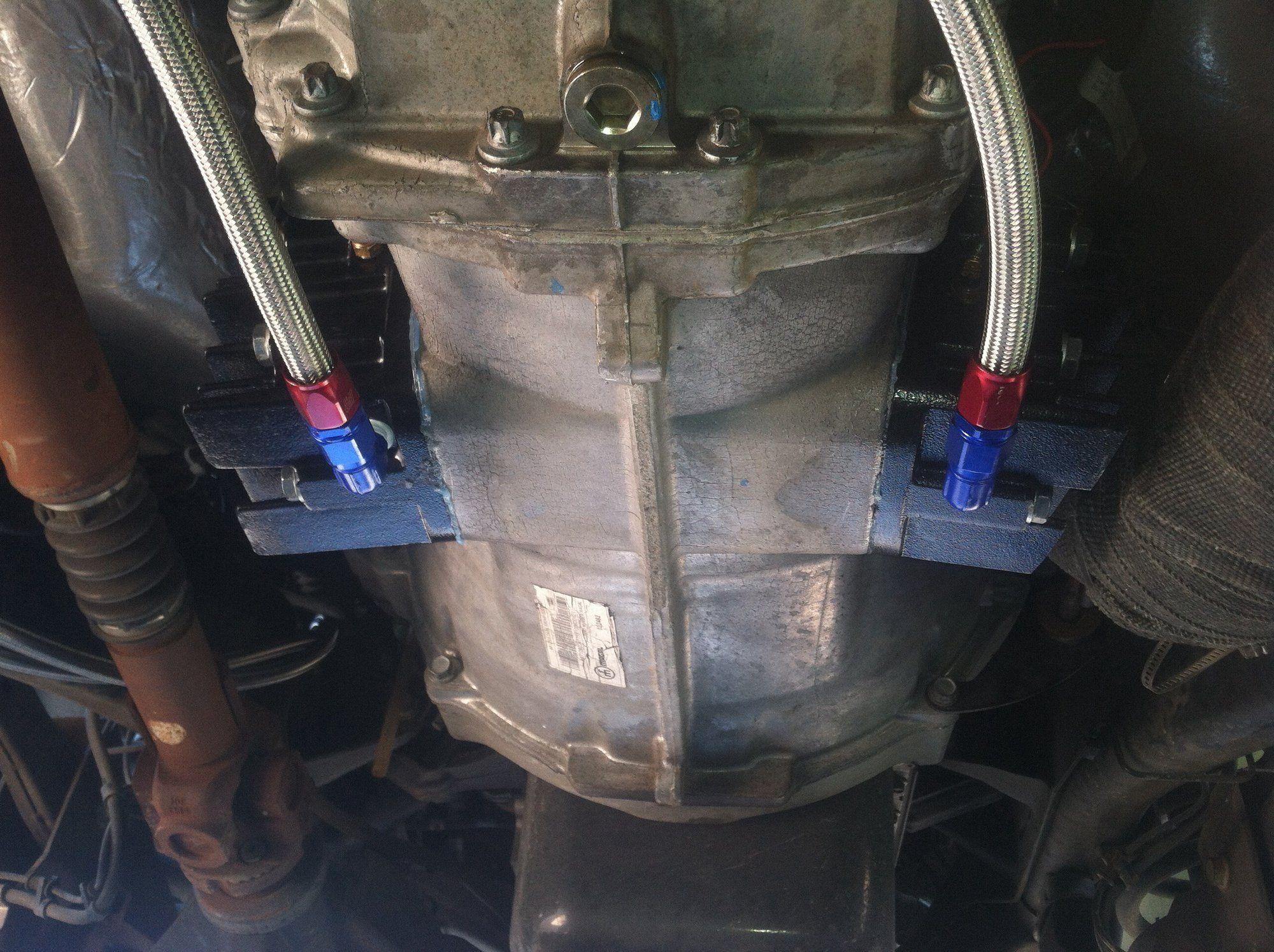

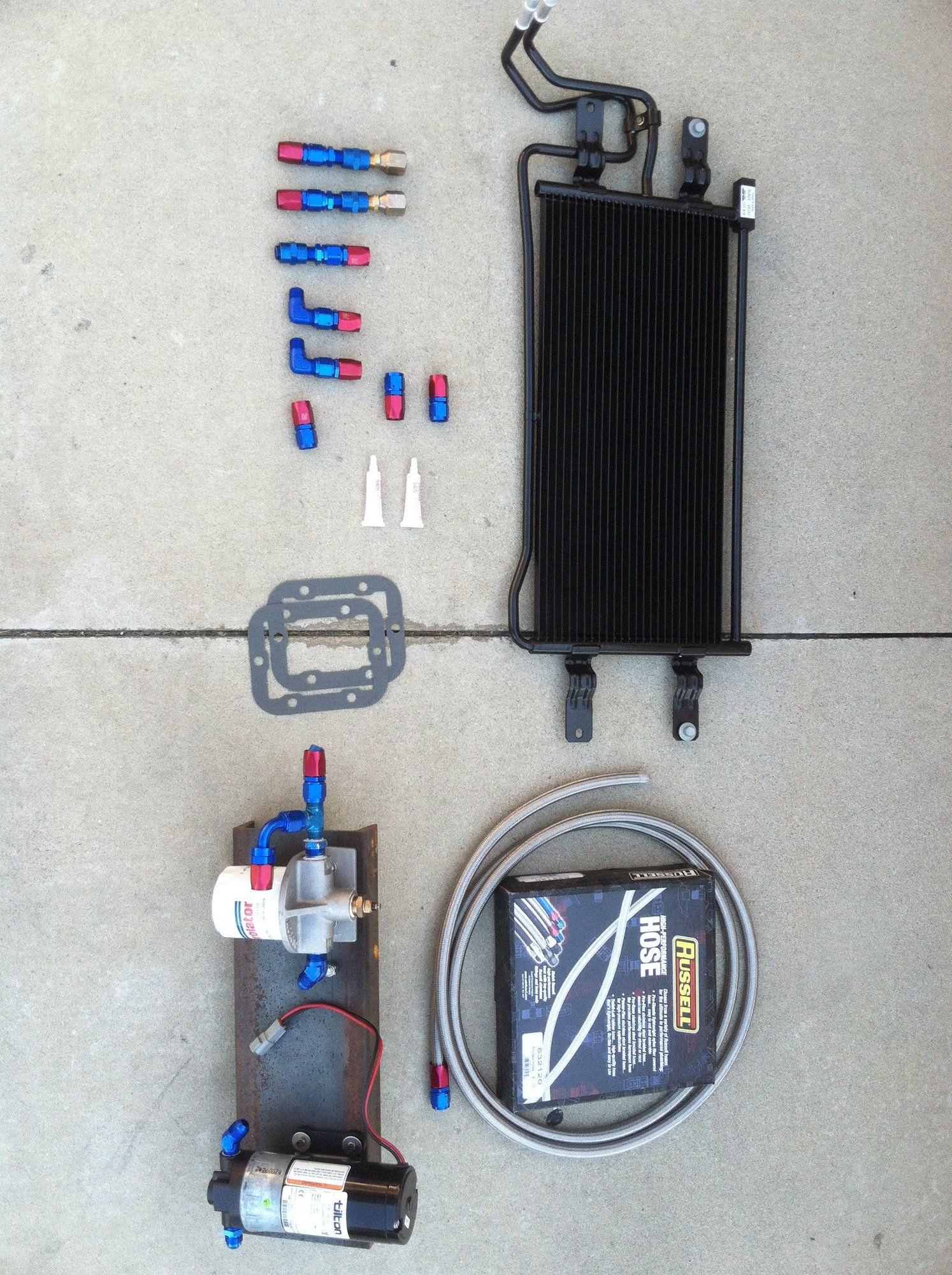

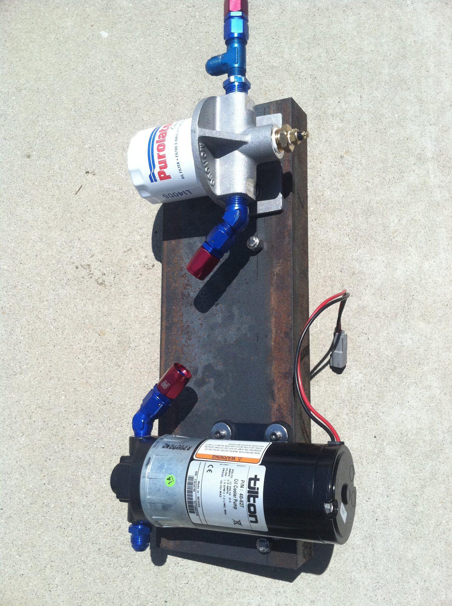

After seeing some others who have done similar due to known high temp issues with the G56, I finally got around to completing my design and install. Pictures follow, when I get time I'll try to put together a parts list. The orange filter is for the transmission fluid, other 2 are fuel filters. The system connects to the FastCoolers, has isolation valves in case of damage or leaks. There is an oil pump, filter, cooler, electric fan. The system has a thermostat for automatic operation, and will also have a manual switch with indicating light in cab, with a relay to carry the motor loads. #ad

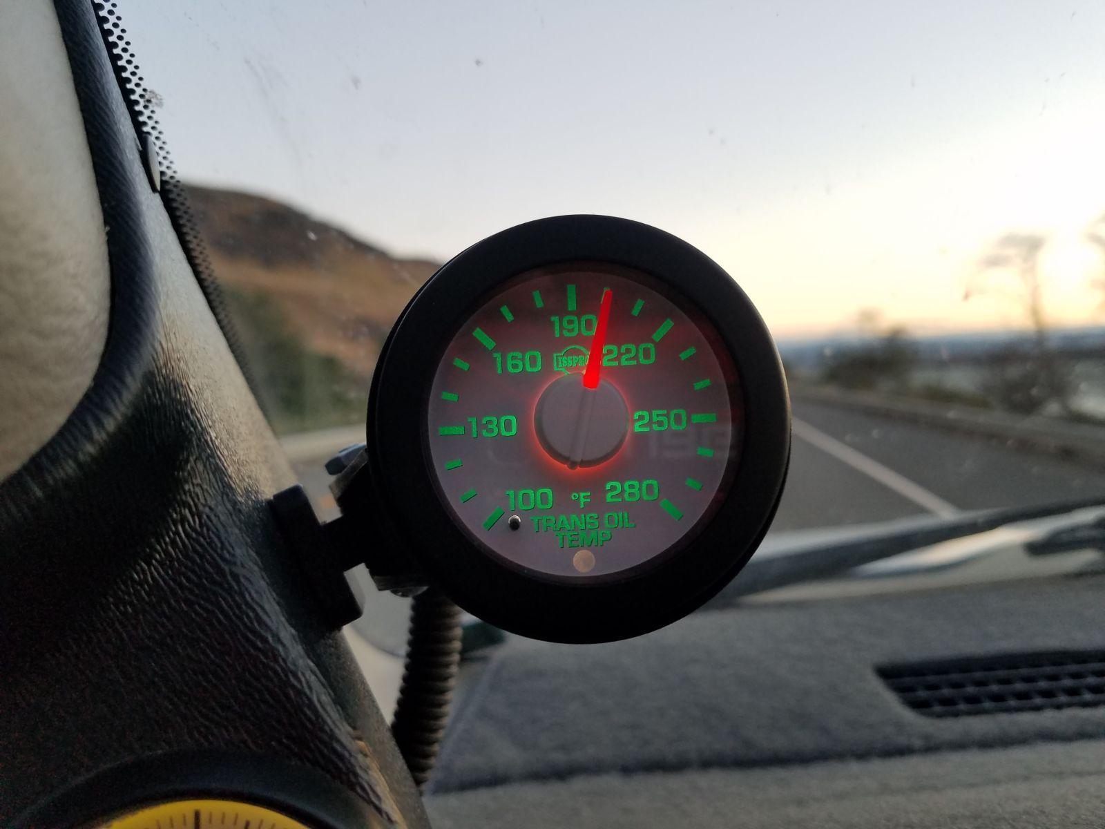

So how hot is to hot? This was taken pulling my 37 ft. 5th wheeler 65 MPH at 75 outside.
I am using Mobile 50wt. in the G56

From what I read on oils, below 200F and the oil is fine. That said, the concern with G56 is case expansion at high temperature, this loosens up the shaft clearances. In the latter case, the lower the better. I have not yet tried a long drive under load with the cooler, but I've manually run it for the secondary filtration function.
Sent from my Moto G (5) Plus using Tapatalk
My G56 got as hot as 250* just pulling my boat. It also browned the bearings, that Standard Transmission replaced at only 30K miles. If yours run cool, I'm happy for you, but I think that most run hotter than 200*. It was worth every penny spent.

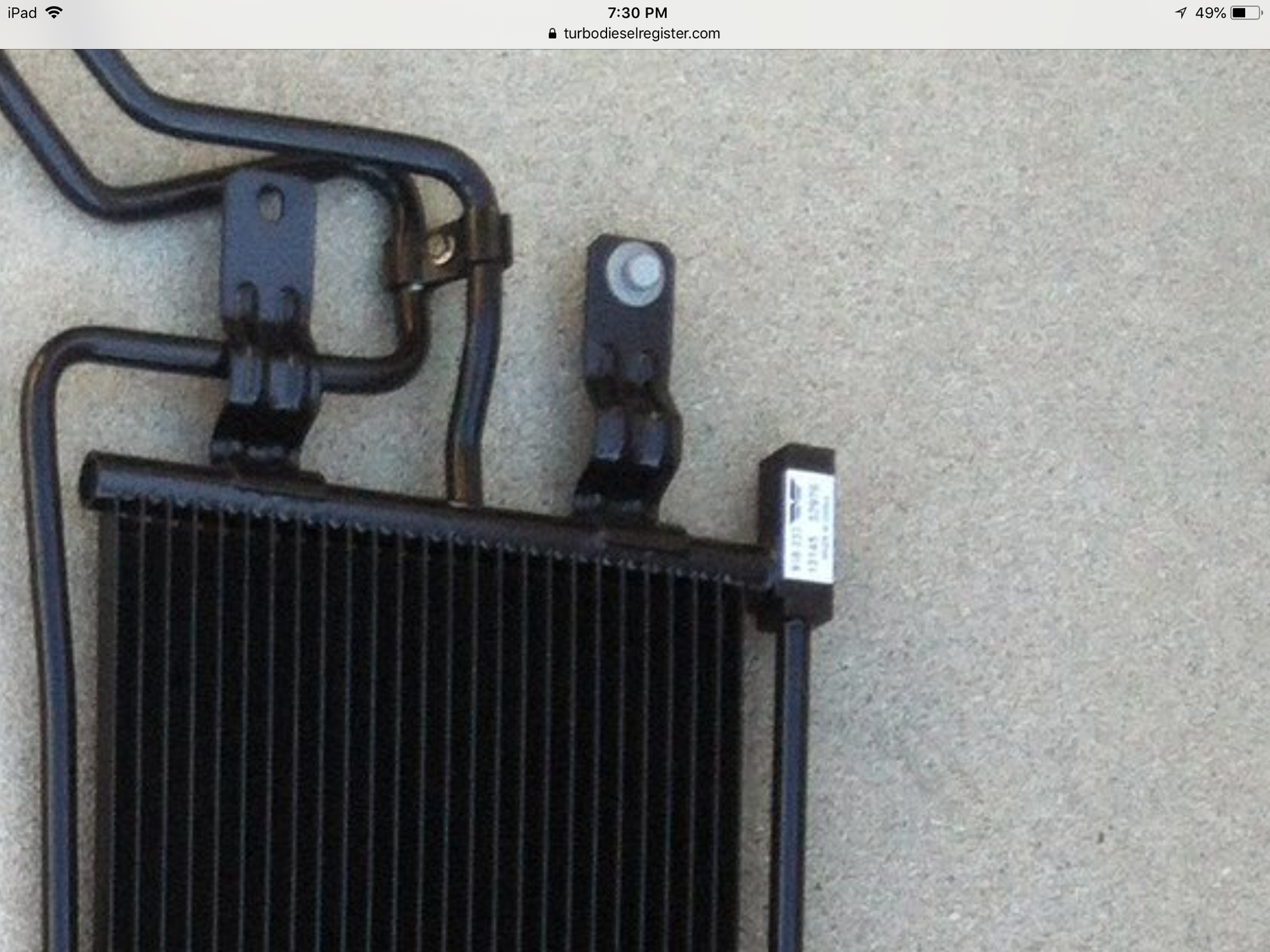

The pump is rated for continous duty, if I chose to always keep it on. The heat exchanger is for the OEM auto equiped truck. The OEM radiator is the same radiator for either auto or standard transmission truck. So I just purchased all the hardware and a heat exchanger for an auto equiped truck. Because it has a thermo bypass built in, I can run it continuos, but I like it to build up the temp first.
If you look at the heat exchanger, it has a thermo bypass (thermostat) built in, that will recirculate the oil back to the trans bypassing the heat exchanger. It closes the bypass after 135*, or so I’m told, and forces it through the exchanger.

OK, here is my list:
Transmission cooler ($42):
https://smile.amazon.com/gp/product/B000C3DDKO/ref=oh_aui_search_detailpage?ie=UTF8&psc=1
Fan ($20):
https://smile.amazon.com/gp/product/B00W758RMO/ref=oh_aui_search_detailpage?ie=UTF8&psc=1
Oil Pump ($58):
https://smile.amazon.com/gp/product/B01MF9830S/ref=oh_aui_search_detailpage?ie=UTF8&psc=1
Filter base ($30):
https://smile.amazon.com/gp/product/B004XOQ0GM/ref=oh_aui_detailpage_o00_s00?ie=UTF8&psc=1
Filter ($15) :
https://smile.amazon.com/gp/product/B0015RCD66/ref=oh_aui_search_detailpage?ie=UTF8&psc=1
Thermostat ($9)*:
https://smile.amazon.com/gp/product/B01LWL6ZZB/ref=oh_aui_search_detailpage?ie=UTF8&psc=1
* Note, consider lower a temp band such as 170 to 185F:
https://smile.amazon.com/Partsam-El..._rd_t=40701&psc=1&refRID=98PJ8FMFPVYKQFX1Q30R
Relay ($14/for 10ea, only one needed):
https://smile.amazon.com/gp/product/B01KVZ2KEM/ref=oh_aui_search_detailpage?ie=UTF8&psc=1
Hose: ($21)
https://smile.amazon.com/dp/B004XONTCU/ref=psdc_15710771_t2_B004XONNMG
Fittings ($16 + $14):
https://smile.amazon.com/gp/product/B017N4TD4O/ref=oh_aui_search_detailpage?ie=UTF8&psc=1
https://smile.amazon.com/gp/product/B017N4TIMG/ref=oh_aui_search_detailpage?ie=UTF8&psc=1
Adapters ($11):
https://smile.amazon.com/gp/product/B0195TQJR4/ref=oh_aui_search_detailpage?ie=UTF8&psc=1
Various Pipe fittings and adapters depending on how you choose to route your cooler lines..
Various steel to fabricate the cooler mount, you'll want some bolts, (self tapping for the frame mount helps, if possible).
Wire
Switch if you want a manual run option.
I would add a Transmission Temp guage as part of your install as well.
FastCoolers (used for threaded fittings for cooler lines, can adapt direct to OEM PTO desired, or use the Fast cooler thick Al cover with adapter plate) FastCoolers provide an additional 2 quarts of oil, but make the clearance to the exhaust downpipe pretty tight): (Geno’s Garage)
https://www.genosgarage.com/product/fc-sg-cover-kit-fast-coolers/transmission-coolers
https://www.genosgarage.com/product/fc-g56-adapter/transmission-coolers
https://www.genosgarage.com/product/fc-6-spd-dg/transmission-coolers
Optional:
Cut off valves (I added as a way to cut of the cooler loop in case of damage/leak while on the road) ($22):
https://smile.amazon.com/gp/product/B0714DT8QN/ref=oh_aui_search_detailpage?ie=UTF8&psc=1
Elbow (depending on where you mount the filter base, may or may not need this) ($7):
https://smile.amazon.com/gp/product/B003GSKX82/ref=oh_aui_search_detailpage?ie=UTF8&psc=1
