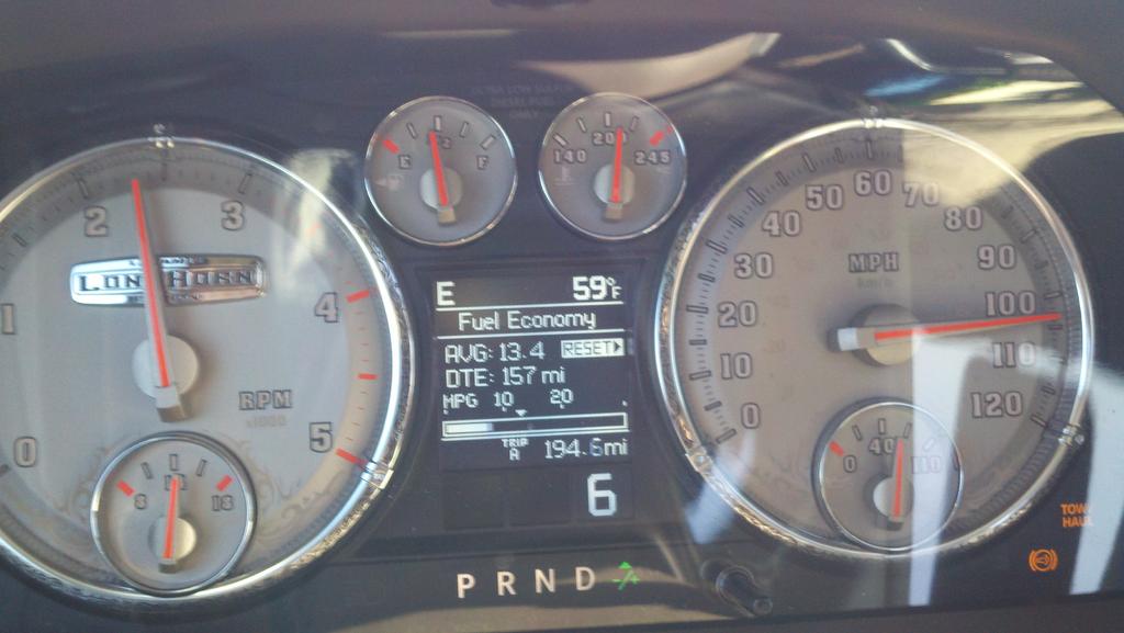

Because 80 MPH IS A CONFORMABLE 1750 RPM AKA LONG LEGS! CHERRY has them. SNOKING
103 was really comfortable in the 2011 Dually! Found out the 15 is limited to 104, too quick to get a pic.
