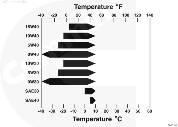

Its a temperature thing on the 6.7 . 0 degrees or below its 5W40, above 0 degrees 15W40 is okay. PER THE MANUAL !!!!
true dat but Big Hips had referenced the 3.0 OM and not the 6.7 OM therefore my comment on preferred viscosity. . LOL

If you look at the chart above, the cold flow for 15w40 is about 5 above and the cold flow for 5w40 is about 15 below. I remember when I first started changing my oil, the Amsoil recommendation was 15w40. Then one day it was 5w40. So I'v been using that ever since.
Tonight I went back and dug around the site and discovered that Amsoil recommends 15w40 for years 2010 and older. And 5w40 for years 2011 and up.
There. MY mystery solved. :-laf

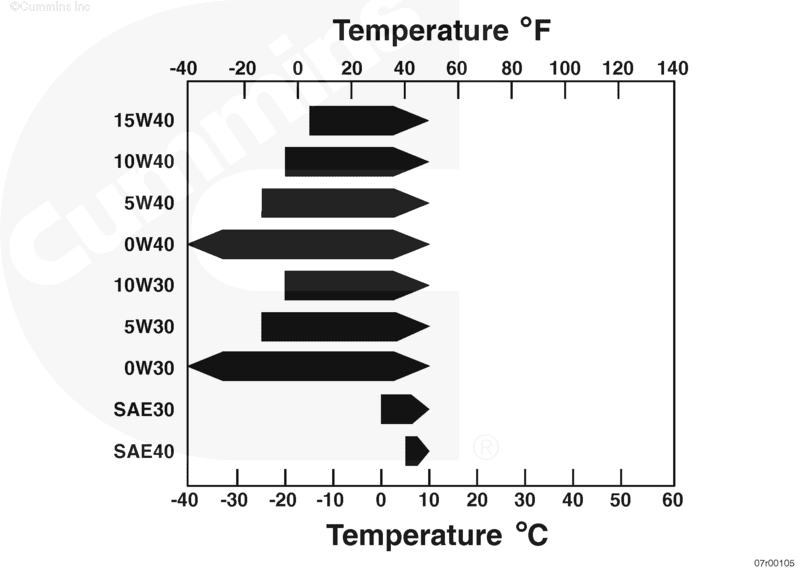

Newsa, this is Cummins recommended oil viscosity chart for temp range. its not like you are I really have to worry about -54 degrees. never get the engine started at those temperatures if it was let to sit outside for any length of time anyway so its sort of a moot point for just about anybody what the pour point it
In late Dec (4 months ago) I was in Illinois and saw negative 17° (-17)F on my EVIC. Never say never. I had 5w 40 in my truck. But after I got up there and did some research, I discovered a high quality 15w-40 has the same cold flow charcaterisitcs as some of the cheaper 5w-40's.
A little more research showed a website of a lube manufacturer saying that as long as the temp is 20°F above the cold pour point, it should flow adequately on cold start. I was plugging in the truck (block heater) on those coldest mornings. That probably helped the oil flow once it was picked up.
