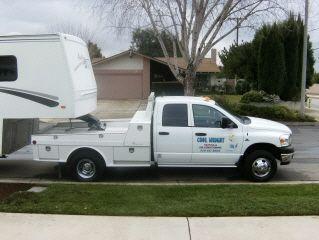

Here is a picture of an ultimate B&W setup with the Companion hitch installed. I toured the plant with a guide and took pictures with thier permission, when they installed the bed, and I can vouch for them, they are top quality, if not the best. The work force is a true American work force, not just made in the USA. The workforce is an intelligent group of guys that I am proud to say that I will only buy from them, if they make what I need.
seems like they are all similar in design... I have a B&W and after some of the crap Ive put it thru. . there will never be any other brand bought... . Its a GREAT design, well written instructions, maintenence free, and leaves me with a clean bed when not in use.
