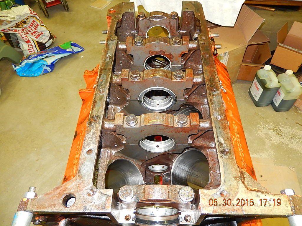

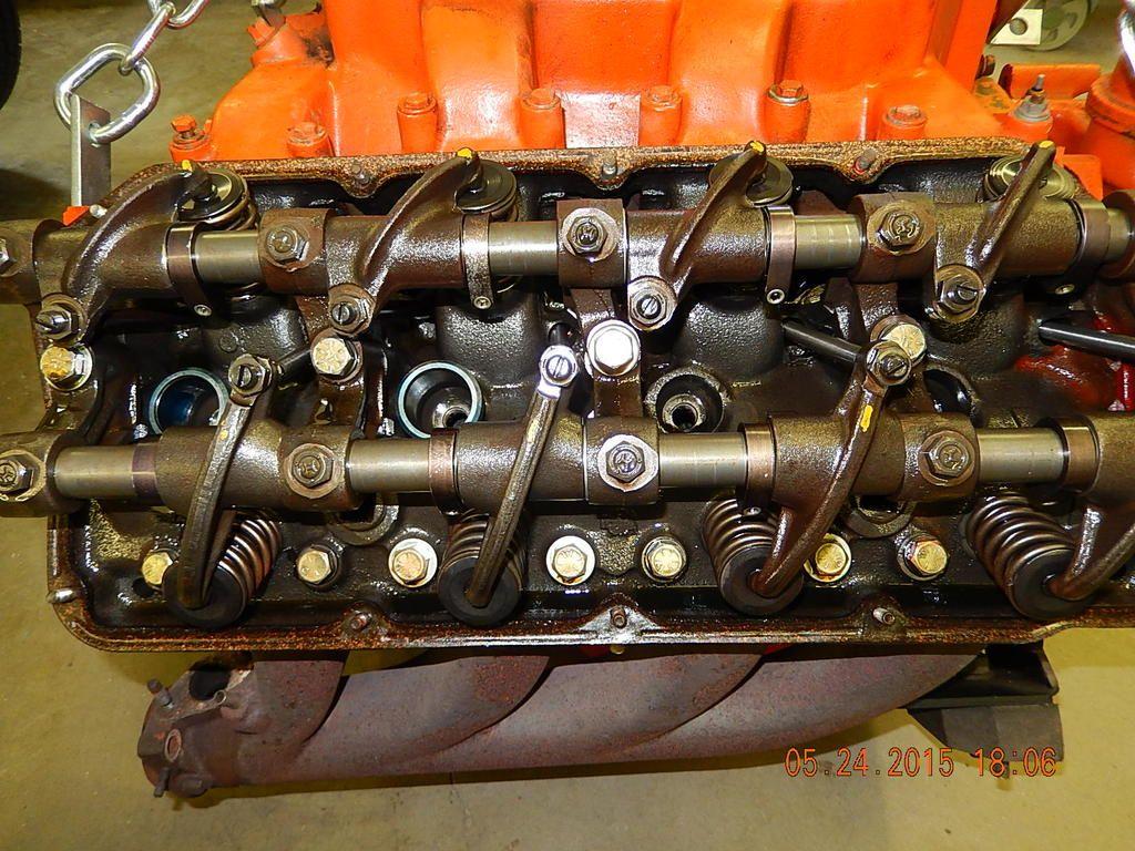

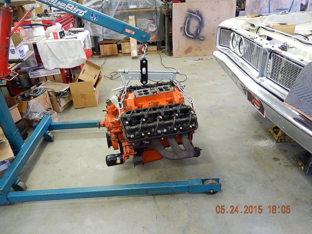

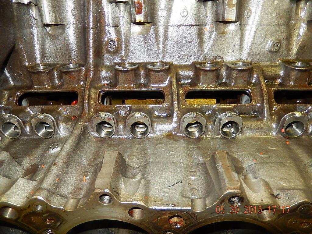

I'm really into the project now. I pulled the engine yesterday to fix a rear seal leak, investigate a low oil pressure problem, install a solid-lifter cam, and do some work on the RH exhaust manifold. Note the hardware store head bolts. I'm curious to see what else I find when I open it up. Despite its size, it's not a difficult engine to remove. I'd rather do this car than my Mercedes or signature truck, that's for sure. I have completed all the other projects, such as new tires, correct 11" rear brakes, radio repair, correct speedometer gear, etc., so I figured I'd get after the engine. One of the beauties of this engine is that I can go to the local dealer and buy parts for it, despite the fact it's almost 50 years old.

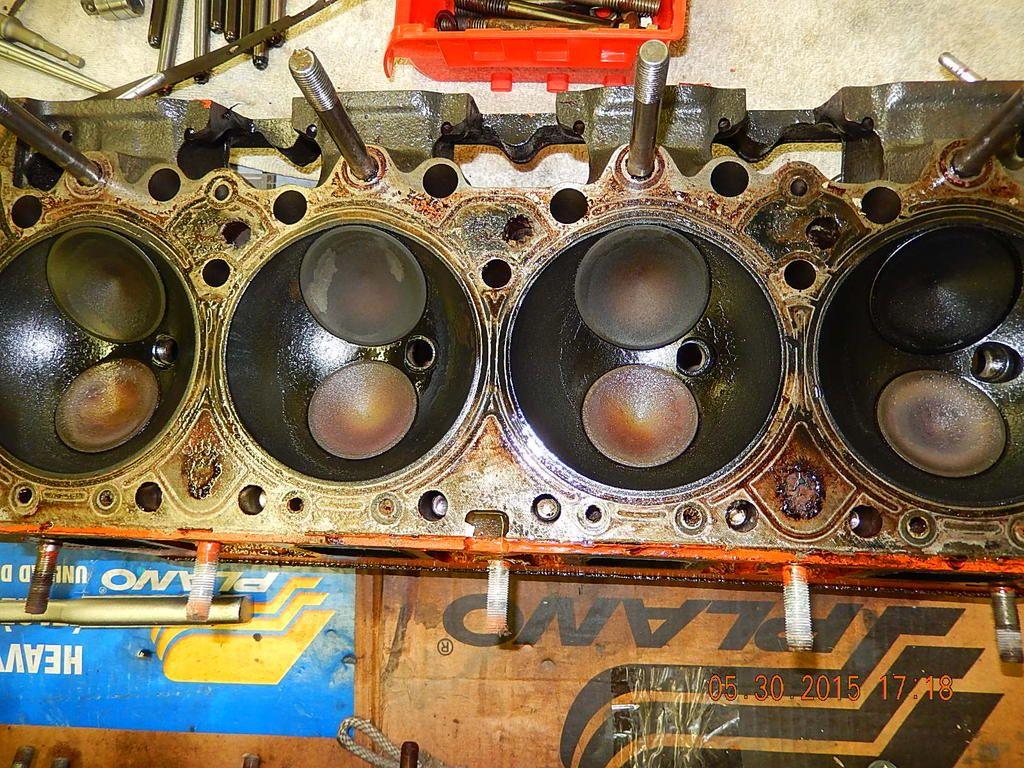

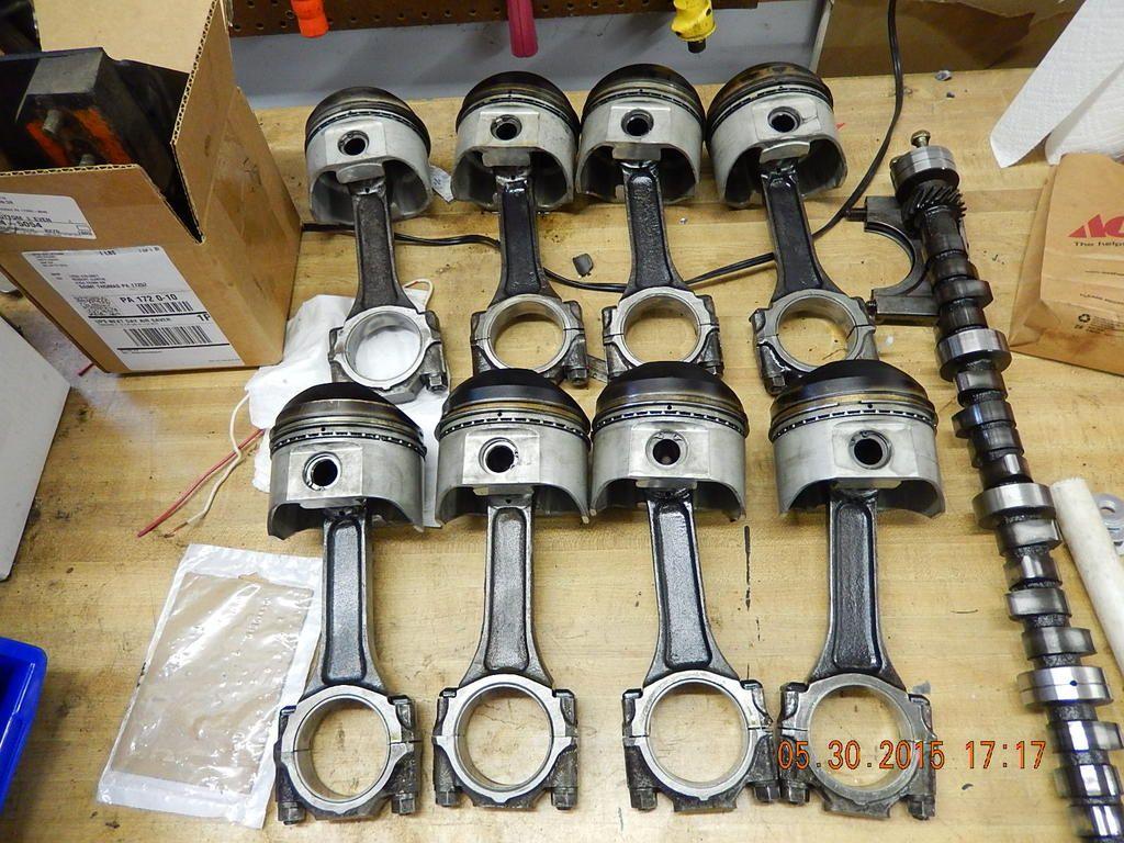

Here's more of the story. I removed the intake manifold and ran the oil pump with a drill. Oil pours out around the valve lifters- they have way too much clearance in the bores. Note that one side has already been sleeved, but they're just as loose as the virgin side. So I disassembled the rest of the engine. The pistons and rings are perfect, but when I took the parts to Ray Barton, he told me that they are 12.5:1 pistons! I can't believe how well it ran on pump gas. The crank was cut beyond safe limits, so it will be replaced, as will the rods and pistons. The block will be honed to .030 OS, which helps piston and ring availability compared to .020 over parts. The rotating assembly will also be balanced. The lifter bores will also be sleeved back to the correct size. When done, this should be much better than new. Here are some more pictures. I'll say one thing, you can see its racing heritage, it's built like a tank.
Hey!!! Hope all's well! Been buried in work- haven't been on in a while. rs, so sorry to see what's going down with the pachyderm! At least you got the right man involved. He will fix you up real good. Now I'd like to know what prompted you to spin the pump and look at the lifter leakage? That was pretty slick. The Hemi does have hard pushrod angles. Which cam are you going with? I agree it'll be well worth the investment-it'll run real well! Ask Ray about those locking collars on the rocker shafts. They aren't stock. They may be old Dick Landy items.
