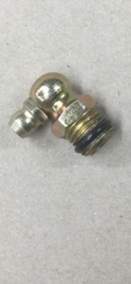

Somewhere long ago I posted a couple photos of an adapter I made from a small piece of aluminum. One hole for the bolt, a Zerk threaded on the other hole, and a small O'Ring. Can't find the adapter any more, I think the neighbor got it.
Ram Man sells an adapter. Good 'ol boy. Sounds like he lives under a flight path.
While I appreciate ingenuity, I think most people can do this with stuff laying around the shop. Thanks for everyone giving tips to save money.
