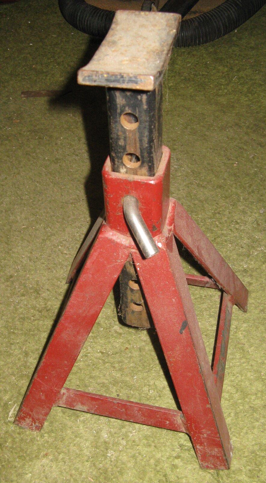

"Ratcheting stands tend to be more convenient, but selecting a pair of stands which use pin and hole, or pin through, technology will give you the highest safety rating."
IMHO, for lighter and smaller vehicles, a quality pair of ratcheting stands are probably fine...that said, WHY mess around with anything but pin type jack stands with the weight of our beloved and mighyty Cummins overhead??

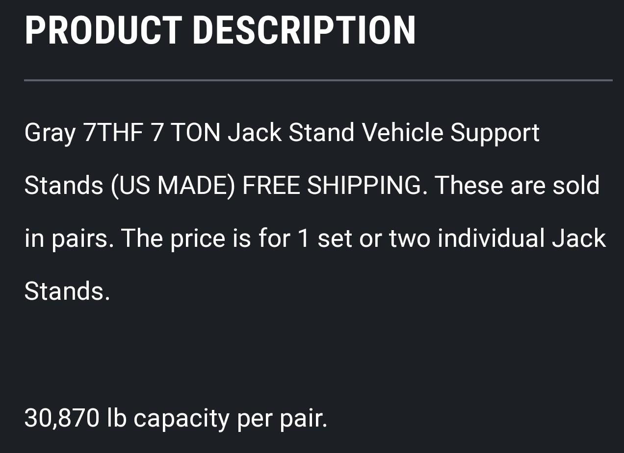

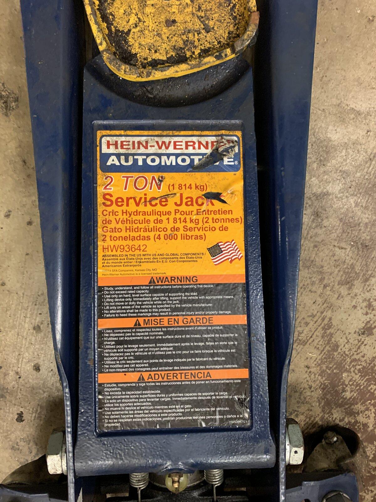

The Gray 10 ton stand says it is 10 tons each and the pair weigh 70 lbs. The Hein Warner 6 tons is per pair, but if you look at the label on the 6 ton stand it doesn't clearly state it is per pair. Typical of BS marketing and a good reason to doubt any claims that company makes.
Safety Standard for Portable Automotive Service Equipment states that jack stands must be rated as a pair and not rated per stand. This became effective in late December of 2015. It also states: “Maximum load capacity per matched pair shall not exceed the rated capacity of the individual stand”.
Separate from that, test standards require that each jack stand must be able to pass a proof load test of 200% of rated capacity for a minimum of ten minutes, with no more than 0.125” reduction in overall height of the jack stand. This is measured after removal of the load. This is actually a separate testing requirement from the rating standard as a pair.
the jack stand base is made overseas and the cast iron support post is made in the U.S. The base is then shipped to the Hein-Werner factory in the U.S. where the jack stand is assembled (insert post in base) and boxed at the Hein-Werner factory and gets the aforementioned labeling.

Also came across this regarding Hein Warner. I don't know if it's true but if it is it's quite misleading on their end.

The 7T Gray are insane rating as a pair.....
They do list them that way as well for the Gray.
