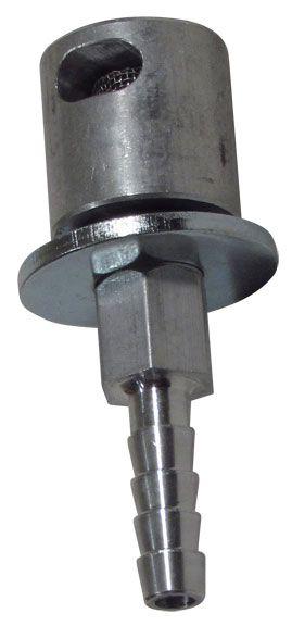

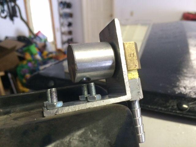

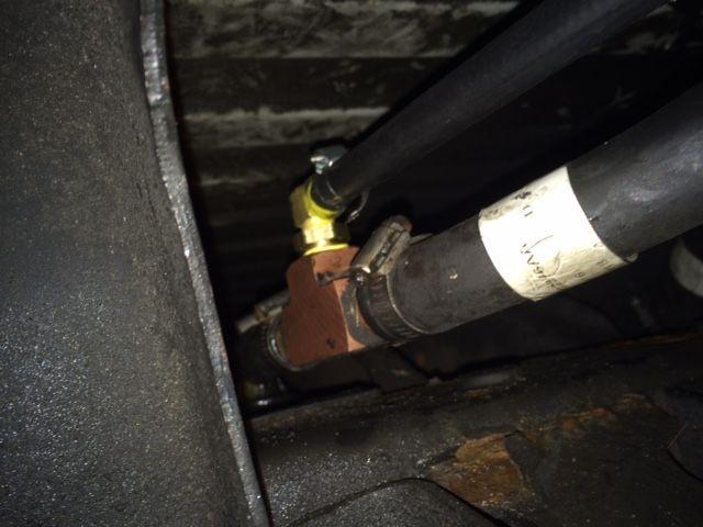

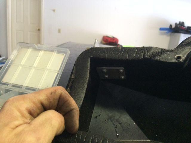

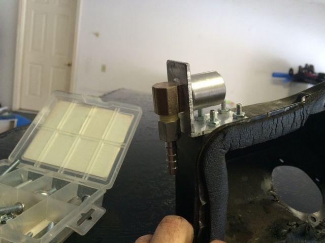

Well, have had the Vulcan modified fuel module in for a week now. Ran it until the fuel light came on and no issues. Sat out over night with the nose up and started fine. Had some trouble with the tank venting so i installed an aftermarket tank vent/rollover valve from Tanksinc into the fuel filler tube using the old adapter from the FASS. No more "woosh" sounds when I open the fuel cap and pressure is up a pound or more compared to before the vent.
. Time will tell if this takes care of the issue or not. Thanks for the help with stuff.
