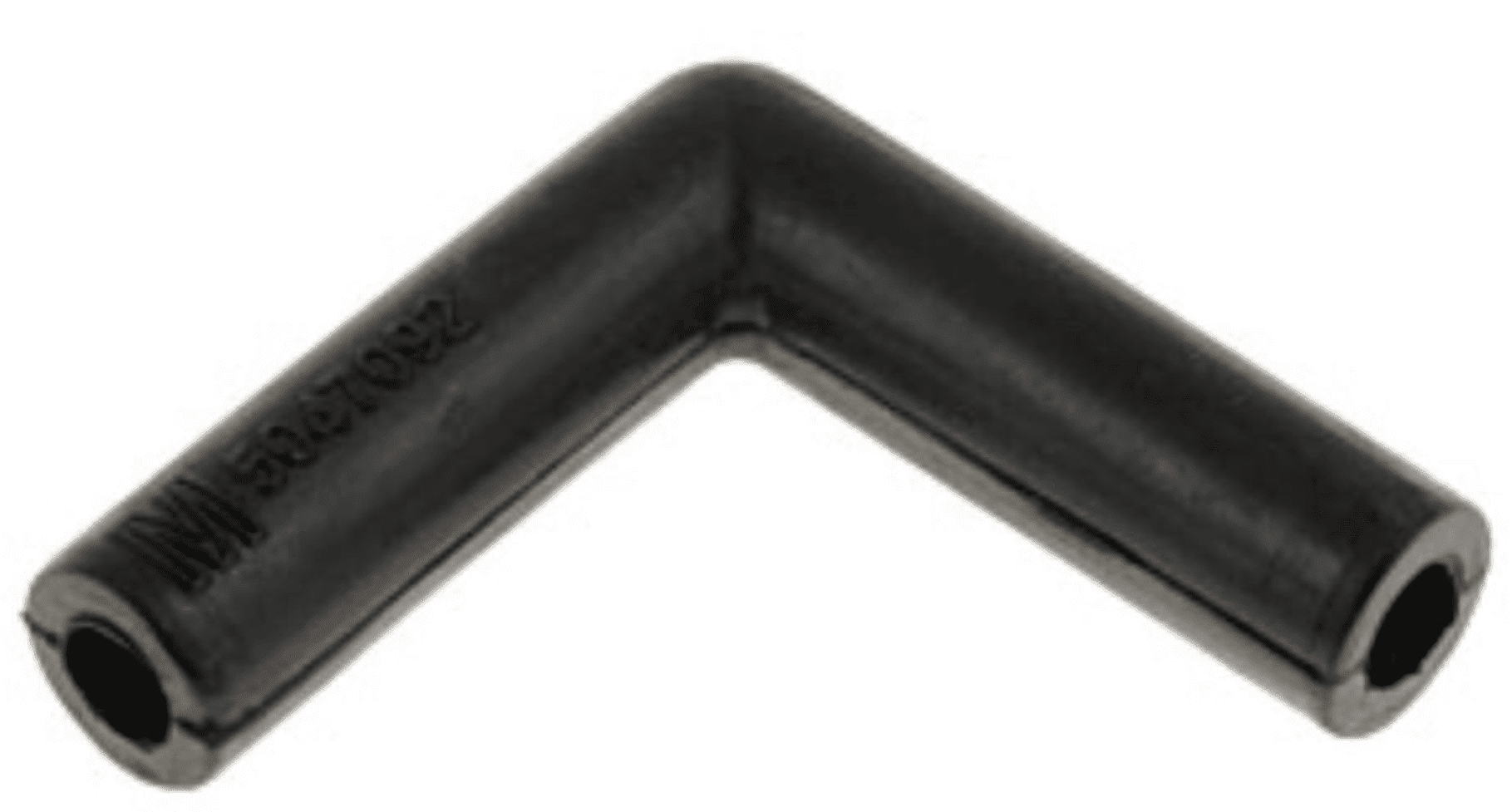

Check the rubber elbow on the vacuum pump. It may be cracked or swelled up and won’t seal when it gets hot. You can replace it with a Dorman 47092. I know O’Reilly’s has them for less than $10. The hard plastic lines will break if you look at them hard. You can use air brake tubing to replace it and vacuum hose to splice them.
