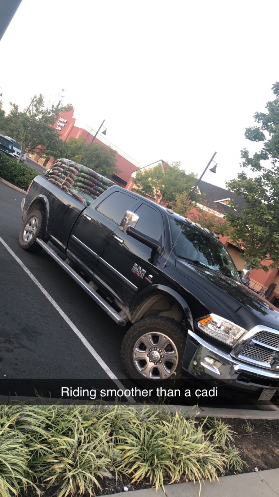

The truck is a 2016 Ram 3500 with 6.7 Cummins. It is a 4x4 Laramie, 35” mud tires, and a leveling kit up front. I installed air bags in the back to help with squatting under the big trailer. Other than that it is stock.

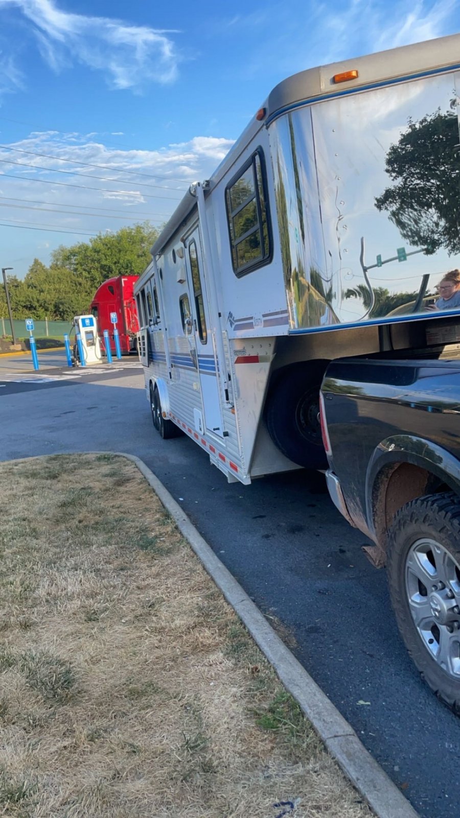

I haul a small landscape trailer(7,000 pounds max) weekly, and a 4 horse LQ trailer(17,000 pounds) a couple times a month.
