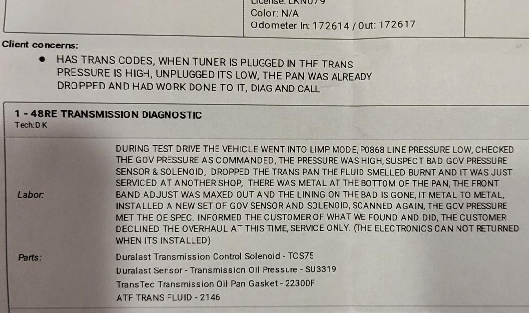

The transmission shop mentioned that it was burnt as well. So, the new fluid has been burnt.

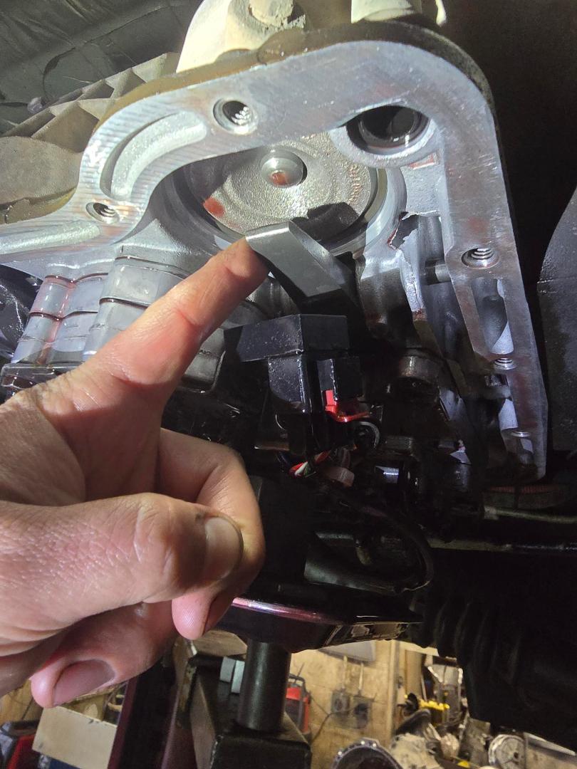

However, they also said that the front band is at its max adjustment and the lining of the band is gone, which could cause the fluid to burn. I asked on the other thread, your thoughts appreciated. Can a band be changed as the other gears and bands are fine? Or is it worth it to do an overhaul or look into a rebuilt transmission?

You can put in a slip in band by yourself which works without dropping the Trans. That can extend the life of the transmission. Was the band ever adjusted during the time you owned the vehicle, milage?
The point for the overhaul is clear, shops do not use slip-in bands. And if you drop the transmission and disassemble it, which you have to do for the normal band, then you overhaul it completely.
With all the work that has to be done to change the band you don't stop there, you make it right.
The band was not adjusted in the time that I've owned it. However, they have been replaced on preventative maintenance in the past. It makes sense that with all the work they need to do to get to that point to just overhaul. I was hoping to avoid getting into my savings at the moment.
Do a slip in Band can be done in the drive way, all you need to do is drop the pan and drop the valve body for that. Pretty basic job.
You shouldn't drive anymore like it is now or it will leave you stranded at the side of the road with a nice tow bill.
