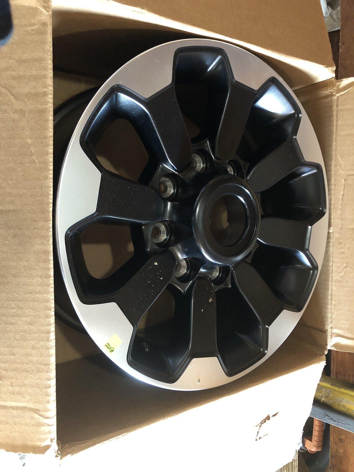

I purchased a set of 17" power wagon wheels (cause I like the look) for my 2018, it came with the 18" Firestone Transforce LR 124 and now I am searching for something in the 17" tire to work. Seems I should have researched more (wish I had a nickel for every time I said that), cause it appears LR 121 is the best I can find in the 17" size. My truck is a regular cab though and maybe the LR 121 will be enough for me? I don't tow or haul heavy, but I also don't want to proceed with the 17" route if it will cause problems latter. Should I sell the PW wheels and go with something like the AEV 18" wheels and another 18" tire?

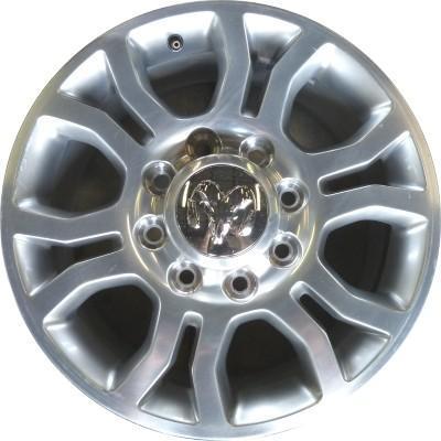

17" tires have become the unwanted step child of tires. I think 3195 is the highest rated tire available. Find a set of 18" take offs. I think the Laramie like this one is the best looking newer RAM wheel.

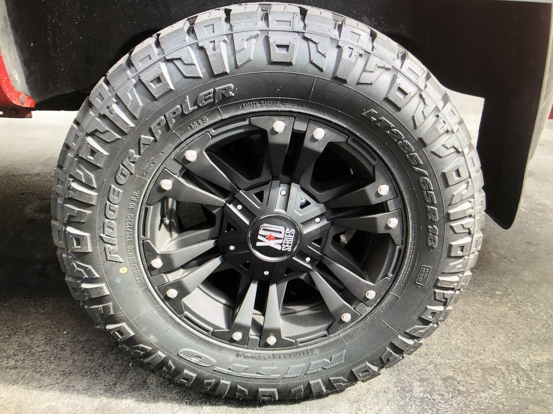

Its a 2500, and I very seldom haul anything, but I do not want to put something lightweight on any truck. Like the fact that the Nitto Dura Grapplers are LR128, they seem to have good reviews so for now since I already have the wheels think I will go with them. Discount tire seems to have the full Nitto line which is another plus for me. Thanks all for your replies!
I too use the Nitto Dural Grapplers on my truck. The size that I use is LT285/70R/17 with a rating of 126R. I have no fitment issue with these tires at all. I do not know how they work in the snow since I swap them out for the factory size tires that I use in the winter.
