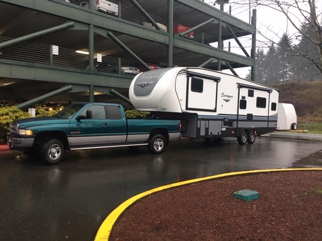

I have a 1998 2500 4wd club cab. I have been towing a fifth wheel for a year now with no problems. Last week my neighbor ( the guy with the drw 2500) tolled me that I was over loaded. We sat down and ran the numbers.
Empty truck weight 7240
Trailer weight 9900
Pin weight 1980
combo weight trailer
and truck 17140
My combo weight is under the 18000 in the manual. The trailer weight is under the 11400 max weight in the manual. The weight on the rear axle is under the max weight limit of 6084. The front axle is under the max load limit of 4850. So everything looked good to me. Till we figured out the GVWR for the truck loaded which was 9220. So it looks like Im 420 over GVRW.
While towing is the GVWR still in play?

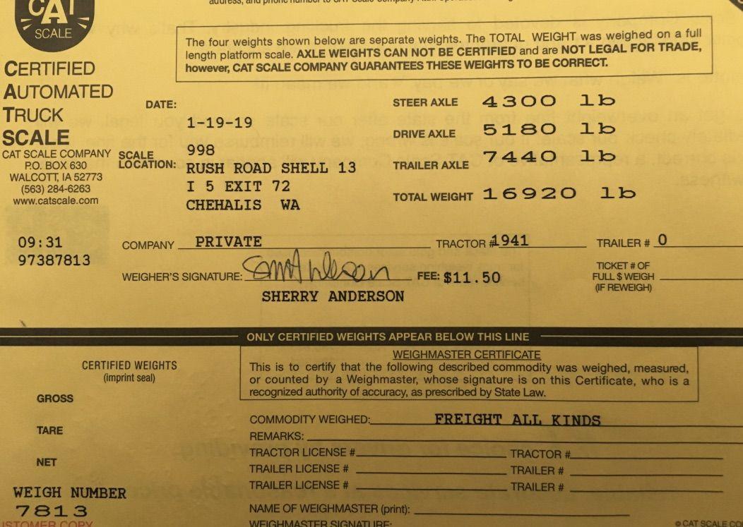

Well here is what I got. looks like the truck scale near me was off. So go for it or replace it with a 3500?
I wish my weight numbers were that good... Again, you're way over thinking this and I'd move away from your neighbor before spending the money to replace your truck.
That said, if you feel that your truck is not handling the trailer adequately then that would be a good enough reason to either get a bigger truck or get a smaller trailer.

I have to say for me it would not be a problem you are well under the axle ratings, and assuming you are running load range e tires well under that rating as well. A few hundred pounds over GVWR yes but IIRC that gen of truck the 2500 and 3500 were identical in almost every way except for the dually tires on the 3500 unless yours is an auto then you would have the D70 axle instead of the D80 on the rear, but you are well under your axle rating so I would not worry about it. Though as Katoom said unless you feel the truck doesn't handle adequately I would carry on.
I do have a automatic trans. It was built by ATS, it has their Triple lock torque converter in it. The rear diff is a D70. The tires were up graded to 17" Michelin LTX 265/70 17 E range. The load cap for them is 3195 ea. It looks level going down the road and handles just fine. Just a little concerned if a something was to happen how the legal end of things would come out.
