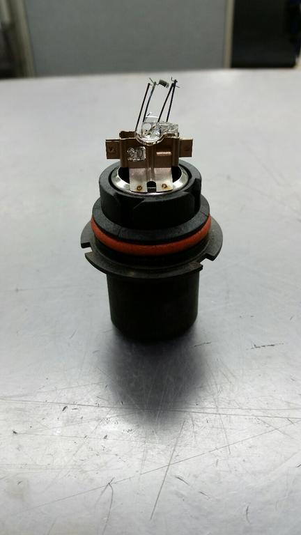

Well, I lost a lamp last night. With both elements burning, when they blow they BLOW!
A low-beam bulb in my stepdaughter's Accord recently exploded like that. First time I've ever seen it happen.
