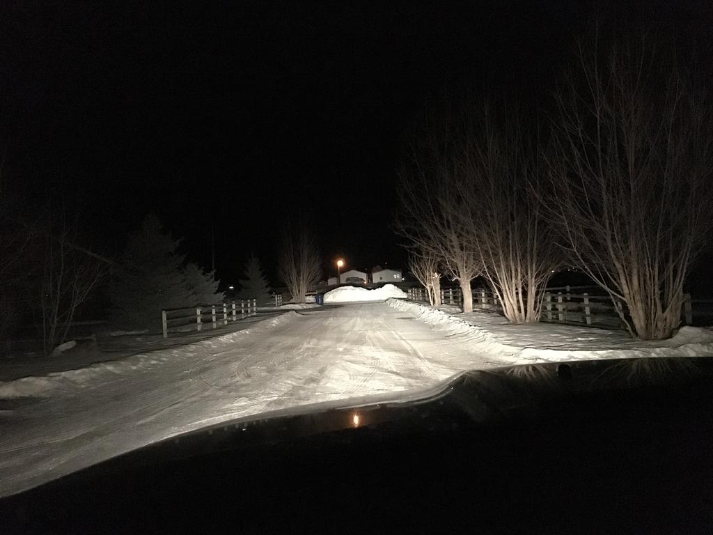

Rigid SAE fog lights only:

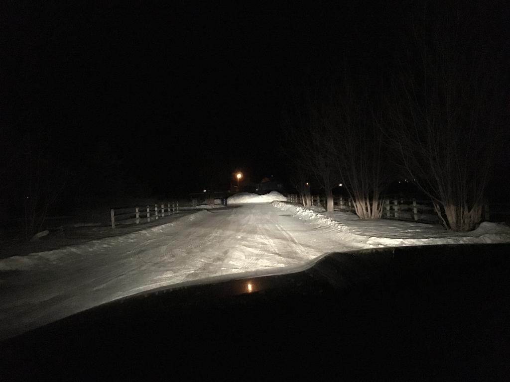

Rigid SAE Fog and Philips low beams notice how well the Rigid's fill in everywhere the low beams arent:

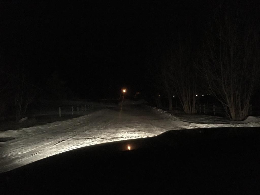

Philips high beams only:

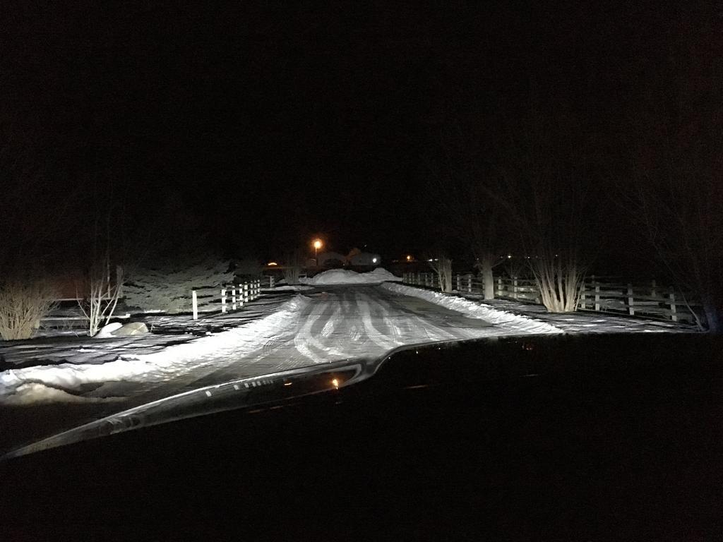

Philips high beams and Rigid D2 driving, again the Rigid's fill in nicely:

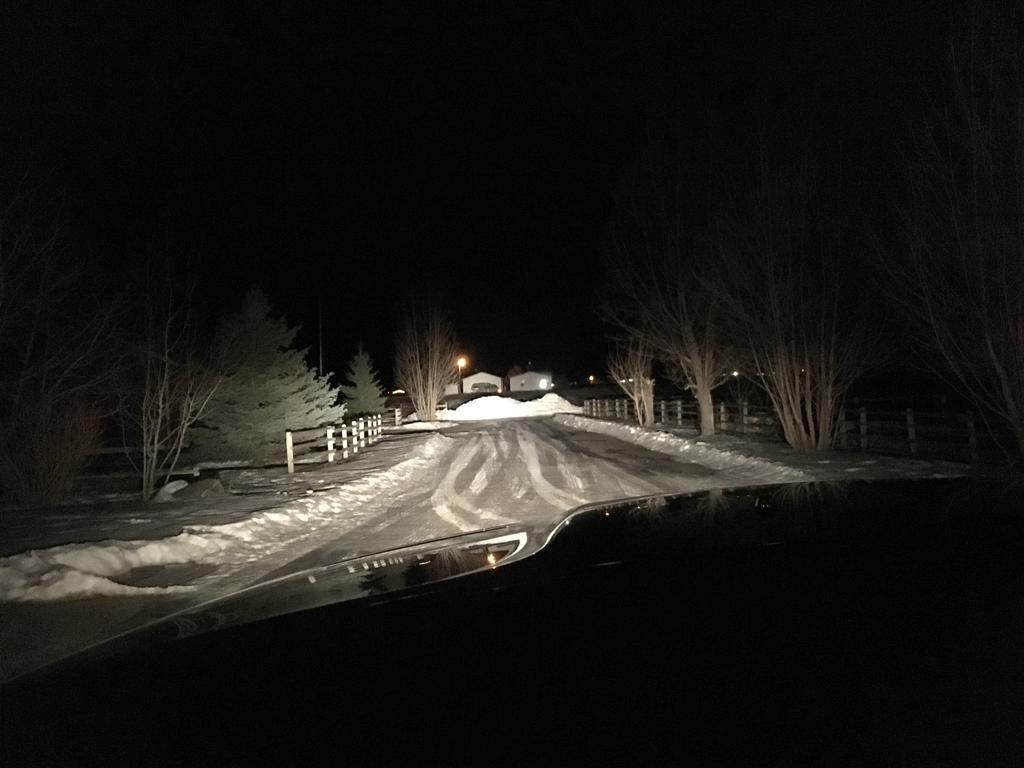

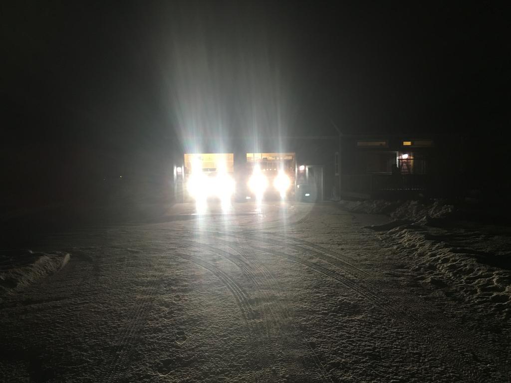

And when you really need to see, Philips high beams, Rigid D2 driving and Rigid E2-20 combo, unfortunately the neighbors house is only about 1/4 mile away, so you cant really tell just how far out the light bar reaches:
