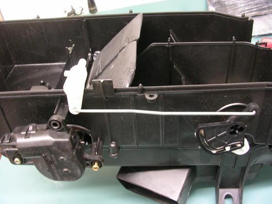

680 21977AB this is the lower case housing. It comes with the mode 2 and rear vent doors. I had to replace the lower case because the actuator pulled the cam out of the housing and wrapped the rod around the mode 2 door lever. Below is a letter I sent to Heater Treater trying to figue out away to make their door work. Let me know if the pictures turn out.
Mark

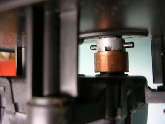

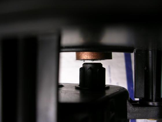

I am checking to see if there is an optional axle / limit pin available for my 2007 3500 mega cab heating system Mode 2 door?
The picture #1546 shows the axle pushed all the way in the door shaft so that the limit pin engages the stops.
#1543 shows the axle connected to the motor and the limit pin is pulled away from the stops.
And with #1544 how would I hook up the connecting rod to the rear heat doors?
