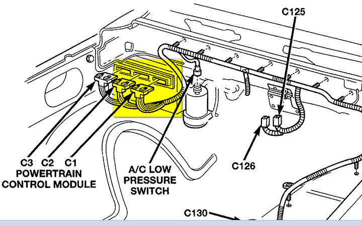

The message you saw is indeed "no bu5" which is short for NO BUS and means the instrument cluster lost communication with the vehicle's communication network. This is usually caused by:
1. Faulty connections at the ECM and/or PCM.
2. A faulty connection where the instrument cluster plugs into the dash (behind the instrument cluster).
3. A hardware or software failure on the instrument cluster.
If you have an overhead display and it also stopped working, that's usually an indication of faulty connections at the ECM and/or PCM.
You can check for a faulty instrument cluster connection by trying to shove the instrument cluster into the dash to possibly cause better contact.
