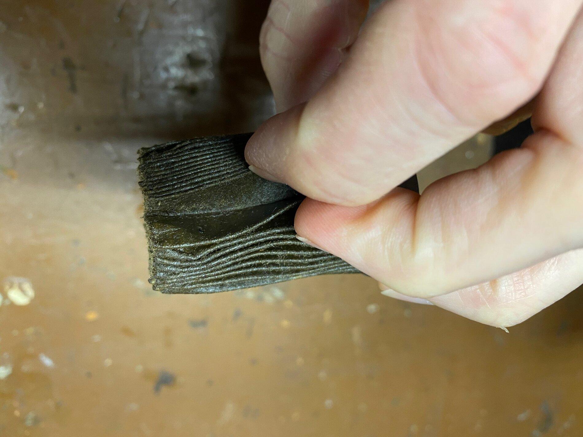

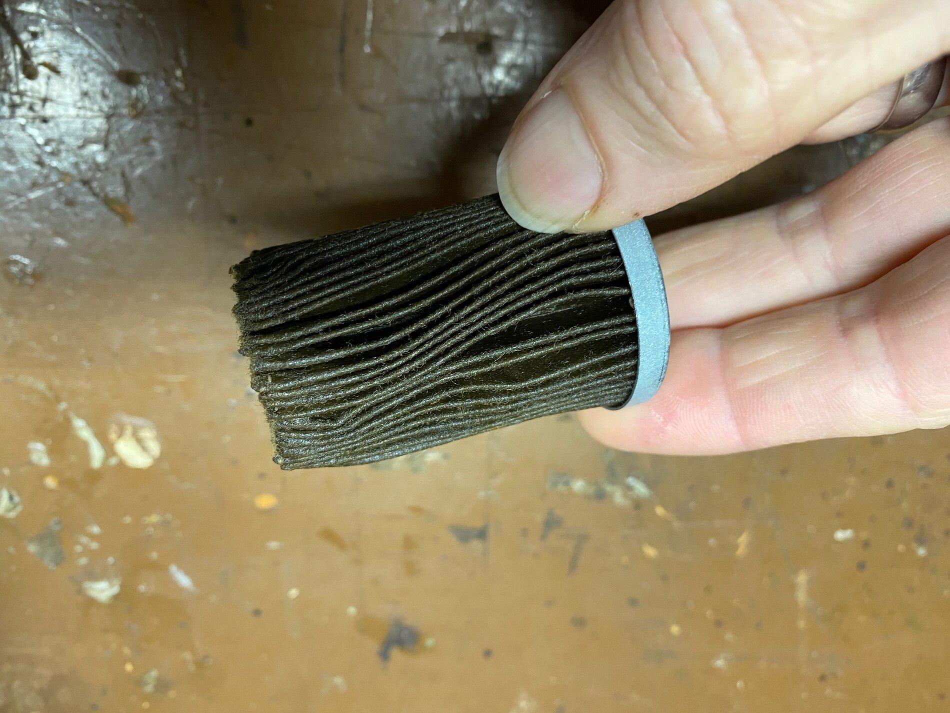

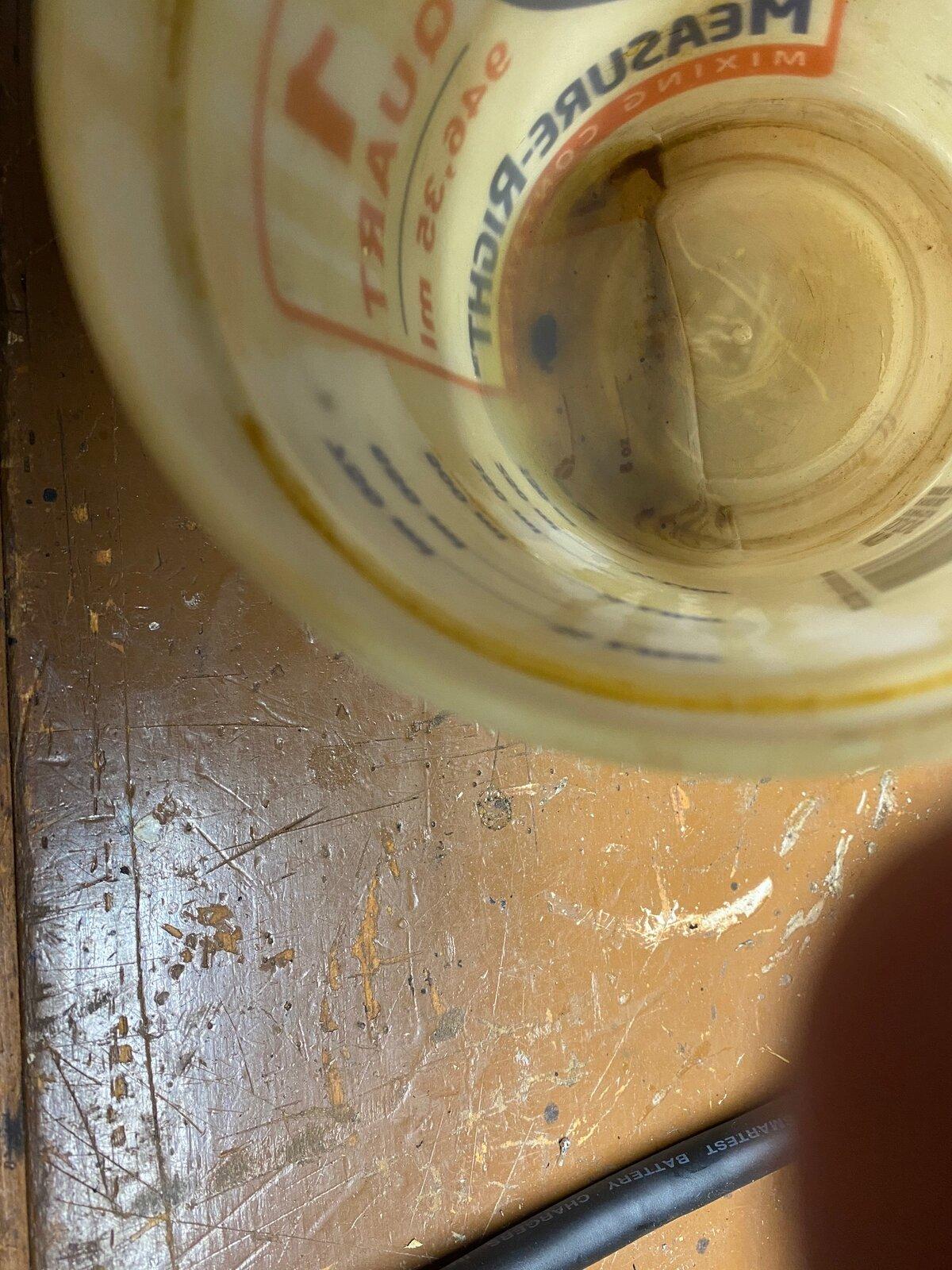

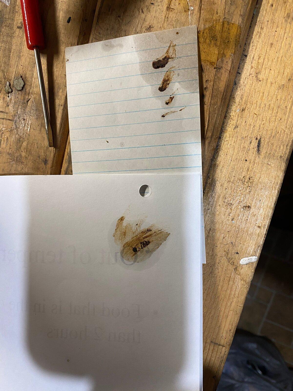

I removed the pre-lift pump fuel filter. It was very difficult to blow through. Definitely restricted. I drained and kept what was in it for inspection. There was one 1/4" drop of water and very fine sediment particles. I cut the filter open and more fine sediment (not adding up to much). I don't think either of these are the cause of it being severely restricted.
This is not a screen-type fuel filter as mentioned by BigPapa. It has a paper element. Do you think the diesel fuel might be incompatible with this paper element, and perhaps the fuel plugged the paper element? This filter was on the truck for a short time - 7 months and probably only a few thousand miles.

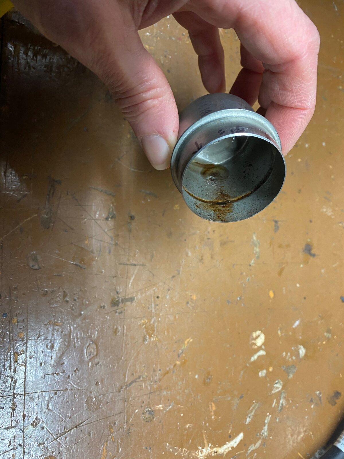

Contents of filter housing:
Scraped the inside of the filter housing:
A small paper element on the suction side of a diesel pump is not the best idea as you have seen. A large paper element of the push side will not have anywhere near the problems noted.
Considering what we know now you should move to an in-tank pump with multi-pass filtration for best efficiency. A 10 um WS to 5 um WS to 3 um solids filtration is about as good as filtration gets and likely will not plug even if you get bad fuel. Even a stock in-tank LP will push thru that filtration adequately for stock fuel requirements. Truck won't run right if fuel is really bad but it should get run.
Your best solution is where you fuel up and keeping those fill ups to 1/2 tank or so if your luck runs out. Water separation is the only way to fix excess water in the fuel, when the WS plugs you change it and keep going given the filters are downstream of the pump. You can treat the fuel with additives to help the pump and contamination easier with an in-tank pump.
Unless the fuel is just sludge even moderately solids contaminated fuel won't stop the truck in its tracks with multi-pass filtration and large filters. The stock cannister will keep a lot out of the fuel system so you just have to deal with floating fines, that can mitigated by limiting fill amounts.
Unless you are sure the plugged filter cam from fuel on the trip, I would change home filling sources as a first step.
