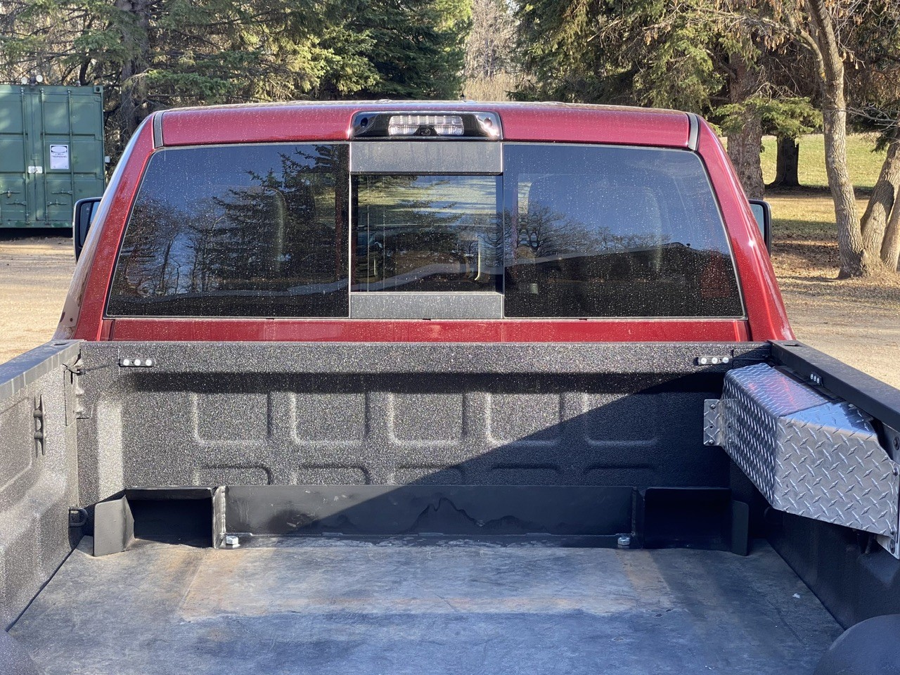

I’ve got 8 triple led light units added just under the bed rails tied in directly to the rear factory led lights. Did this on my 2018 and my 2023 and never had any issues at all. No relay, direct tied in.
You can see a few of them here, rest are just under the rails spaced out towards the rear.
