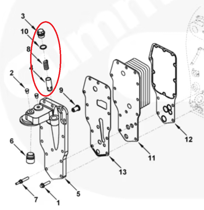

Since you have a mechanical gauge there is a chance the gauge is bad and there is a chance your oil pressure regulating valve is bad. The oil pressure regulating valve is supposed to open at 75 psi and route oil back to the oil pump inlet. It threads into the oil filter housing.
It would seem the gauge is accurate as the pressures seem normal when the oil is warm and the pressure regulating valve isn’t in operation. I would still verify the accuracy of the gauge thou.
This is the valve.
View attachment 139605 Check oil pressure with another gauge (a cheap one I had laying around) it is within 2psi of the auto meter I have installed. Plan is still to change oil in about 700 miles and also check the oil pressure relief valve which I'm there, And see what happens. Last oil change was way over my normal 6000 miles, I had pushed it to 8500 miles, (used/leaked 1 1/2 quarts).
