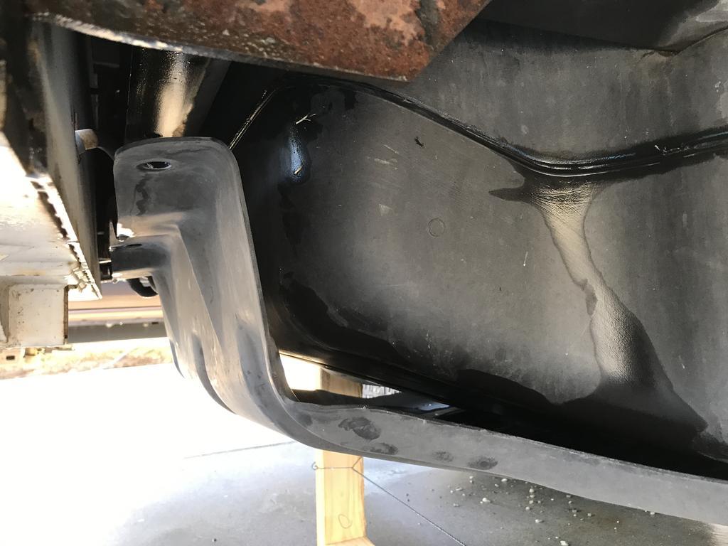

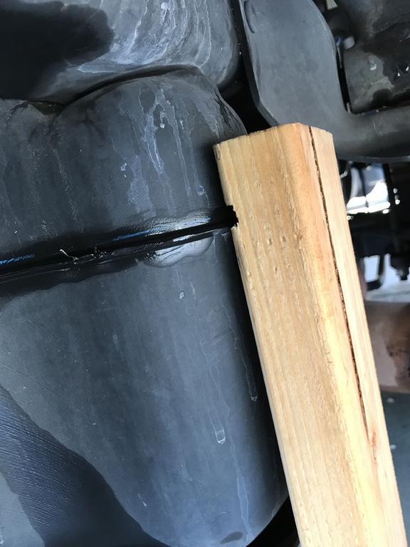

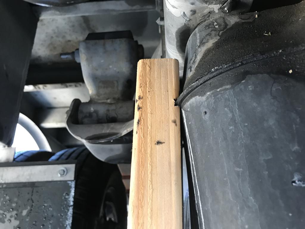

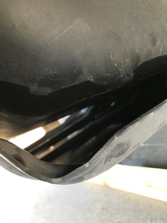

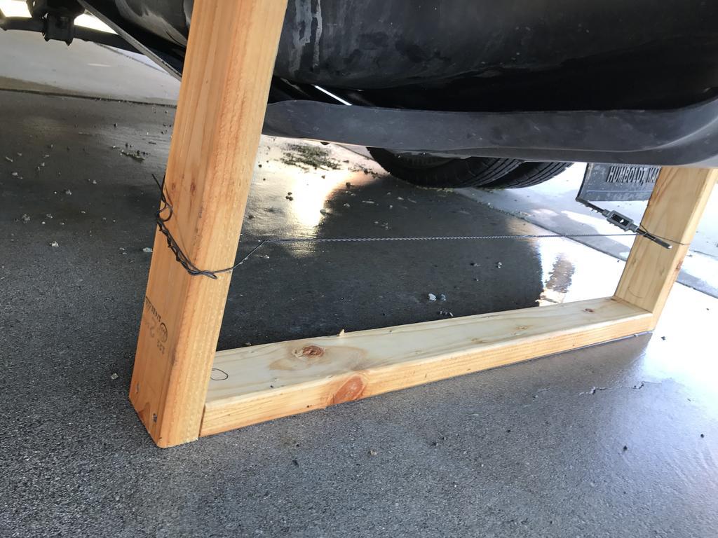

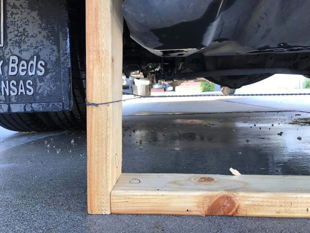

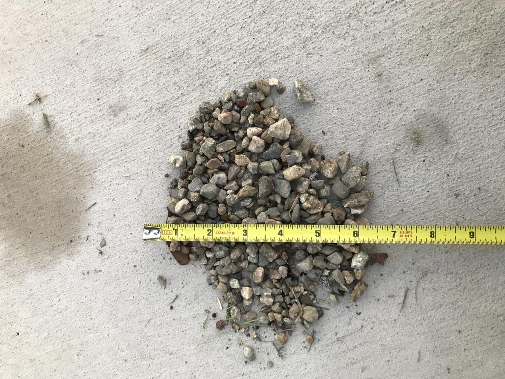

I was to able to remove the pea gravel without removing the entire plate. here are some pictures of my home made tank support. I supported the rear of the tank and removed only the rear bolts to the plate and pulled it down enough to allow me to wash out the pea gravel then reattached the plate.
