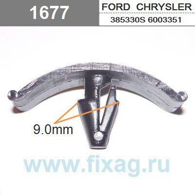

Does anyone have a picture of what these look like ?. I have one that pulled through the insulation. Can I remove the retainer without breaking it ?.

The Dodge part number for the retainer is 6003351.
A quick Google search turns up many photos like this:
Tons for sale on eBay, etc.

"But will the retainers remove without breaking." In my experience - No. Out of the fifteen I removed on my '96 only two did not break and they were not really reusable afterwards. They looked just like the one pictured in JLandry's post. Perhaps you could fabricate a thin tool that would slide in and disengage the moveable portion of the clip to facilitate removal without damaging the retainer.

Thanks guys, that is exactly what I needed to know. The picture helps a lot John. I will fish around and see if I can remove it without breaking. Sure miss the old days when they were spring steel. The noise would not bother me (Growing up with solid lifter cams and glass packs) but the paint on the hood going south would really p**s me off. I do not know if that would occur with no insulator but I do not want to take the chance.
