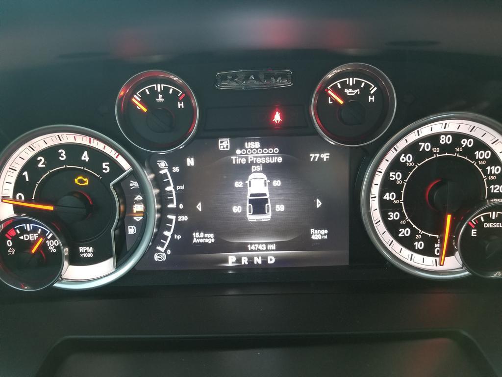

Just to let you guys know it is very possible to change you tpms lower threshold. Dealers don't have the ability anymore (feds took it away) you have to find someone with an autel and acquire a 4 digit pin from your dealer that's tied to your vin. Cummins forum has a list of people around the state's that have these and will help you. Good luck.
Up yours feds lol
Just to let you guys know it is very possible to change you tpms lower threshold. Dealers don't have the ability anymore (feds took it away) you have to find someone with an autel and acquire a 4 digit pin from your dealer that's tied to your vin. Cummins forum has a list of people around the state's that have these and will help you. Good luck. View attachment 98754
Up yours feds lol
Yep, Zedman is correct. Had mine done a few weeks ago. I run the front at 60psi and the rears at 45psi when not towing the 5r. No light, no ding and no evic message "inflate to 80PSI".
