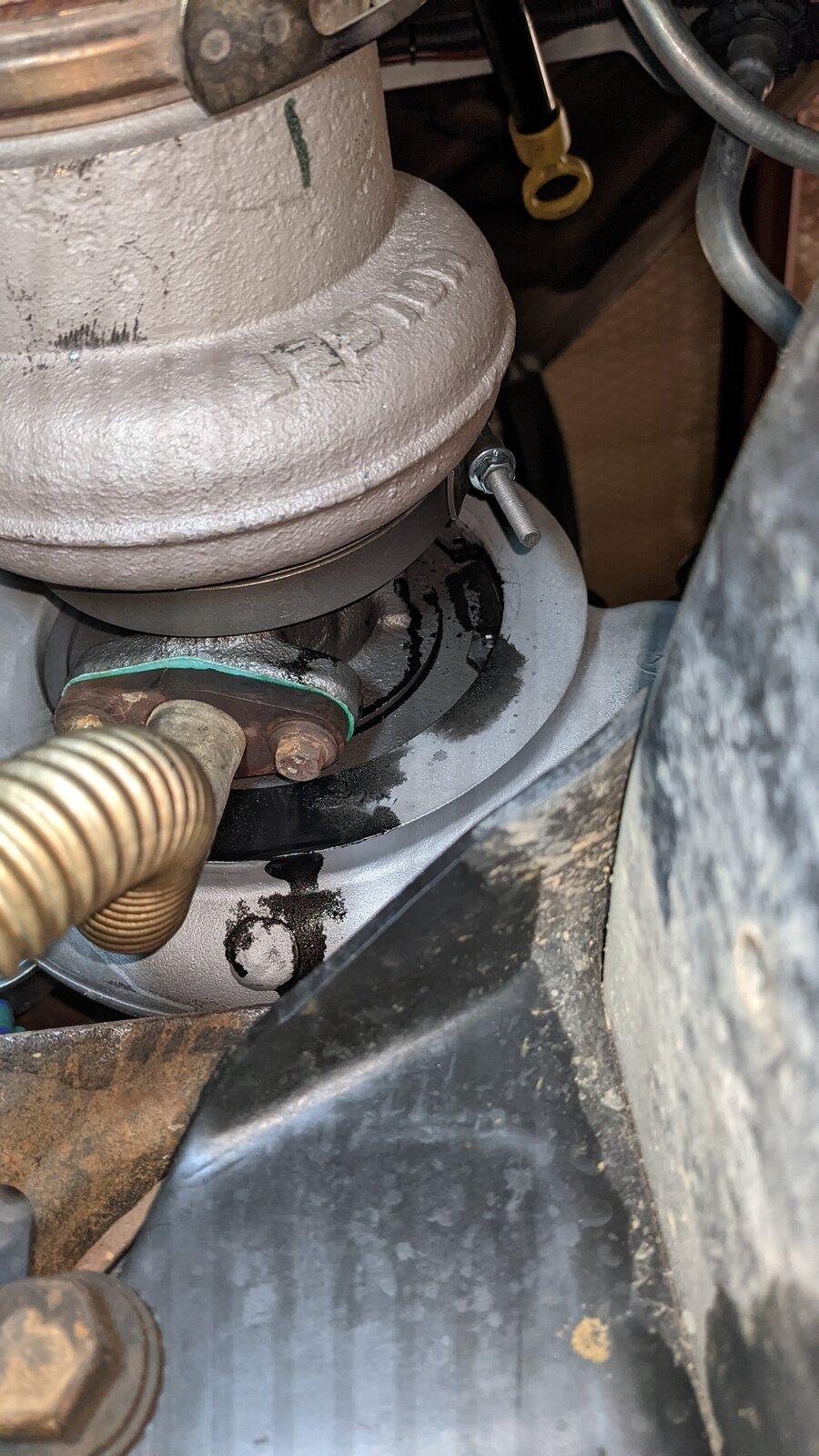

Looks like leaking turbo to me, where else could it be from? That looks mighty oily, not safe IMO. I would park it till the intake was oil free. As far as tuning the stock Smarty tunes they have out these days don't smoke much at all. My 03 runs clean on SW5, all stock.

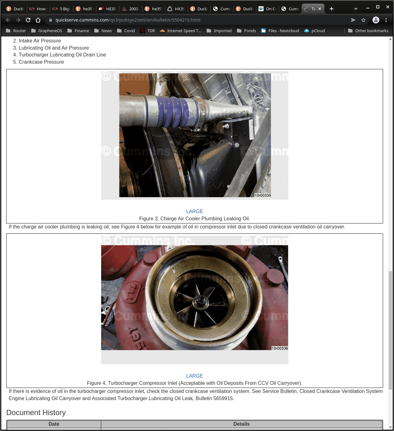

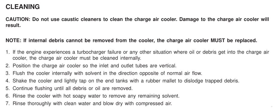

Intercooler cleaning instructions from the manual below
I double checked the drain tube, removed it and ran a fat screw driver down into the oil pan while reaming the orifice. There are no obstructions from drain to the bottom of the oil pan!
That leaves excessive crankcase pressure or the turbo.

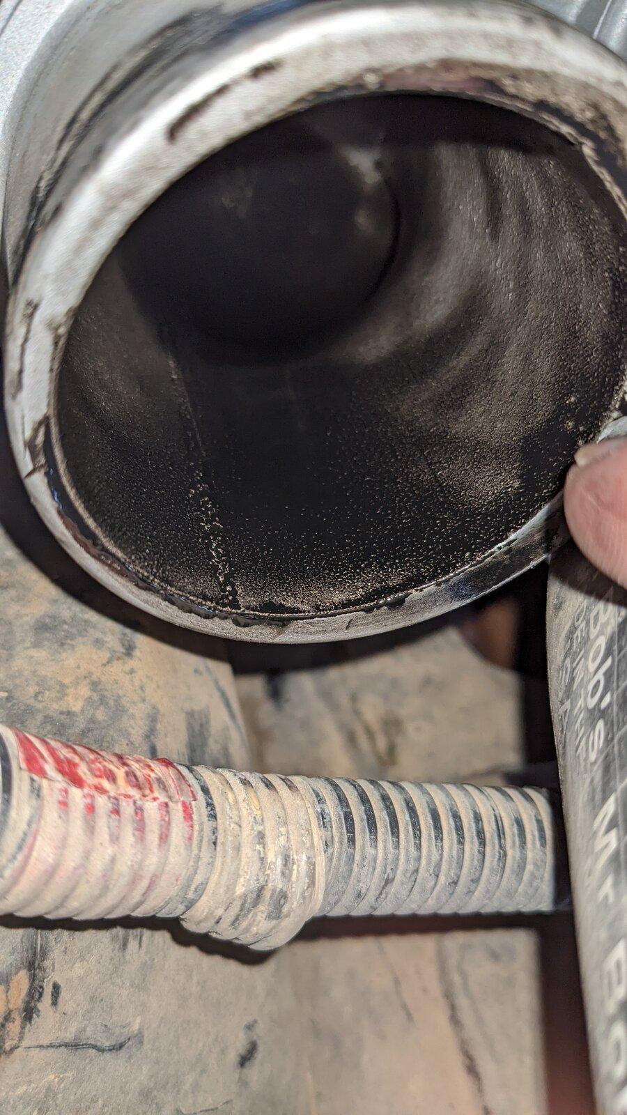

Cleaned everything up and went for a spin. saw 32 PSI on boost a couple of times. Turbo is still spitting oil.
At idle the oil fill cap, when resting over the oil fill is not dancing around. I dont think I have excessive crank case pressure.

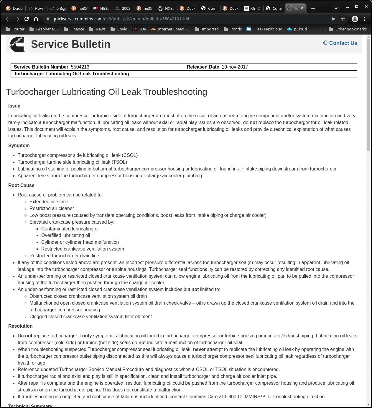

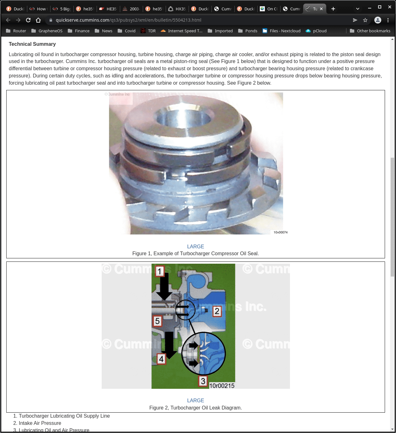

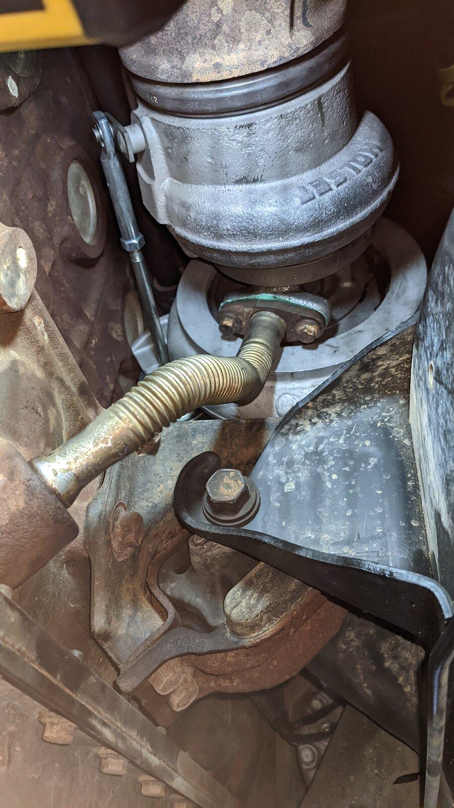

Well, one day on the excavator turned into 2. Didn't make it to the turbo shop before Christmas eve. So in my down time I opened an account on the cummins service portal where i found a TSB on turbo oil leaking, and bought a holset repair manual. From the holset manual it expliclty states that the drain tube cannot have any bends in it that are less than 30 degrees from horizontal.

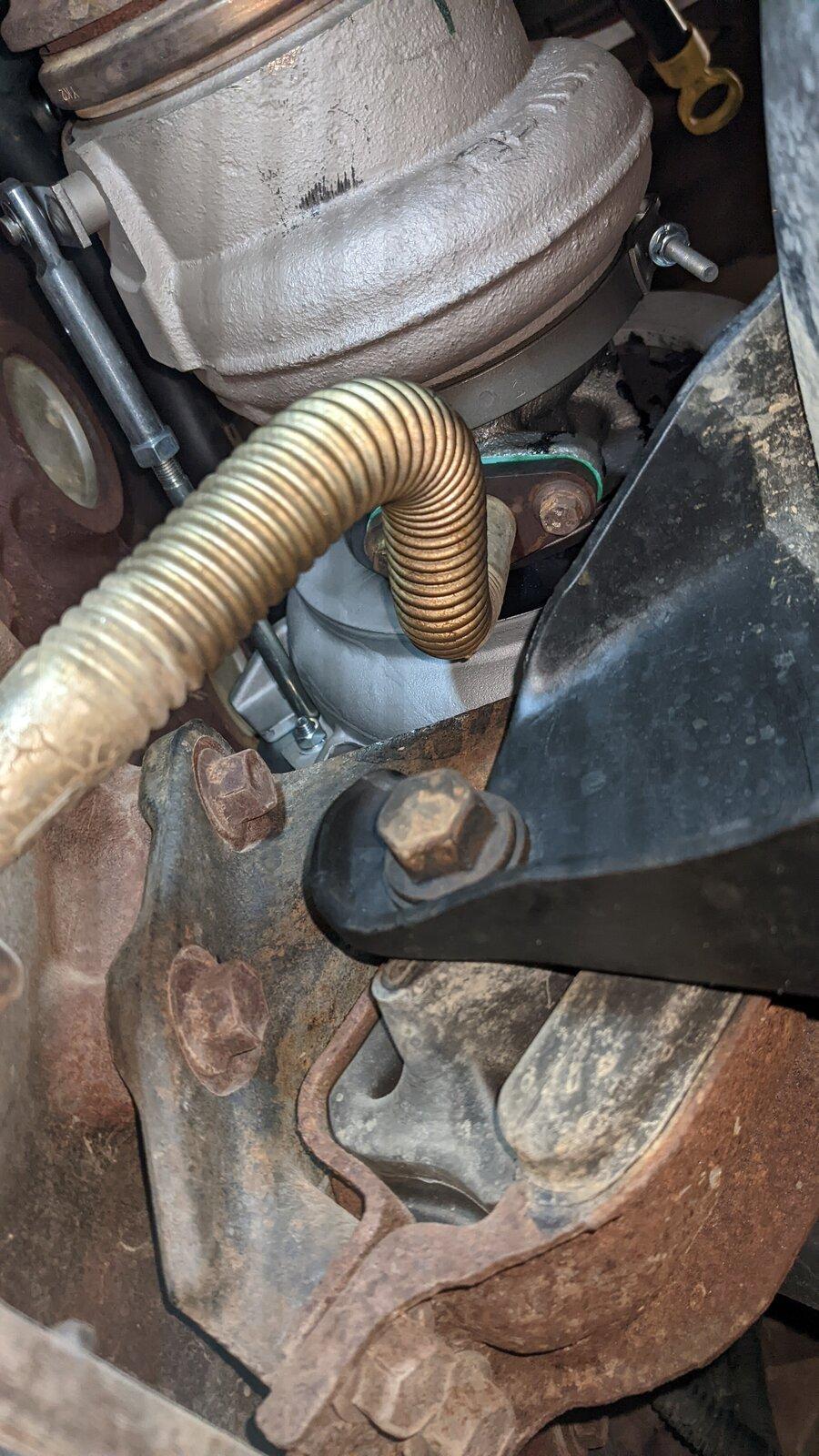

enter my drain pic. Does that look like < 30 degrees? I removed it and sure enough it was. So i straightened out the bends and compressed it by hand. From the turbo drain to the oil pan is only about 8". So i made it shorter than needed and stretched it up to the turbo drain.
Here's the new drain orientation. Voila! no more turbo spitting oil.
Here is the TSB - had to do screenshots as they wouldn't let me download anything but a web
page.
