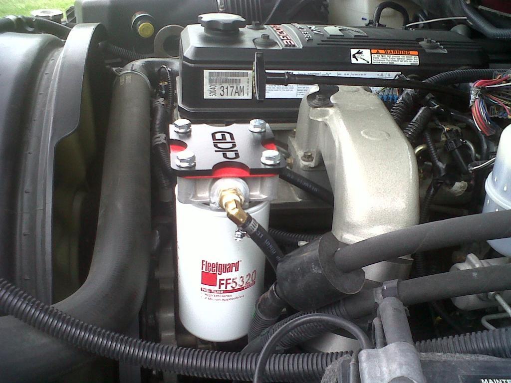

Cerb beat me to it. At least fill up the FF canister with SeaFoam, run it for a couple of minutes and then let it sit overnight.

I had good results with the Seafoam treatment recommended - filled up fuel filter housing - ran for 3 minutes, then let sit for 2 days. Noticed no slight miss, and the throttle response is crisper. I will do this at every fuel filter change [ usually I do at 12,500] I run diesel from only truck stops, or the private fleet fueling service that is available, or my farm tank that is treated with Power Service white bottle.
