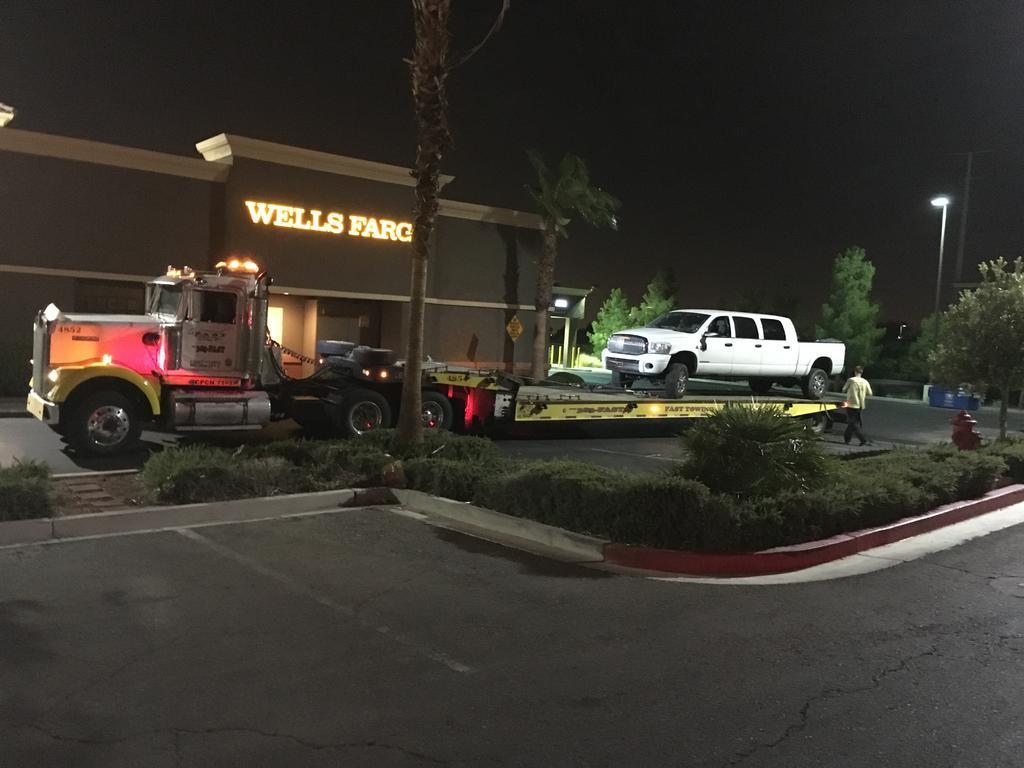

I know this is a really old post, but i read through all the posts and did not see a final outcome on this. Craig did you ever finish the project? If so did it work? I'd like an update. I have a 2007 6.7 2500 (6) door custom MEGA MEGA CAB truck with bad blend doors. Currently ordered the replacement kit from blend door usa which makes the aluminum blend doors, also got the aluminum drivers, going to replace the heater core and air condenser. Paying someone to do the job, because of the time and money around $700.00. This is my first attempt to try to cool down the 6 door truck, we just bucked it up last summer due to us just buying the truck used set us back a pretty penny and now this year we want to cool the entire 6 door truck down including the 3rd row. Our custom truck did not come with additional AC you only get the front dash and the rear center console nothing else. And it doesn't blow good at all on the front and behind the console. Getting no air. Were hoping this does the trick, if not next year we would invest more money in a system as described by Craig. We have no choice we have 4 little kids in car seats that are dying of heat stroke every time

we pull them out. So any updates or advice is welcome.

By the way, did you mean to post 7 different pictures? I would love to see some interior shots of that truck.
