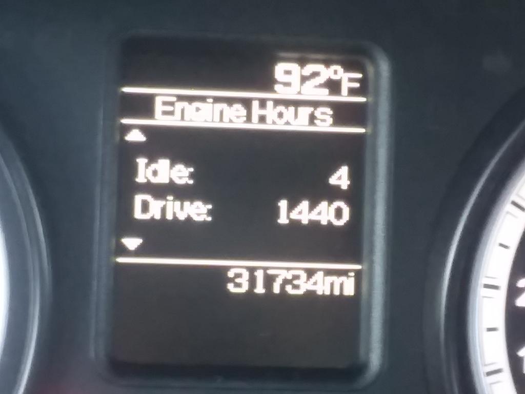

As indicated in the picture. I have 4 idle hours.
Sept 18th, 2017will be my 4th anniversary with Blue Brute, my 2013 midnight blue tradesman.
4 idle hours in 4 years..... Not bad, eh?

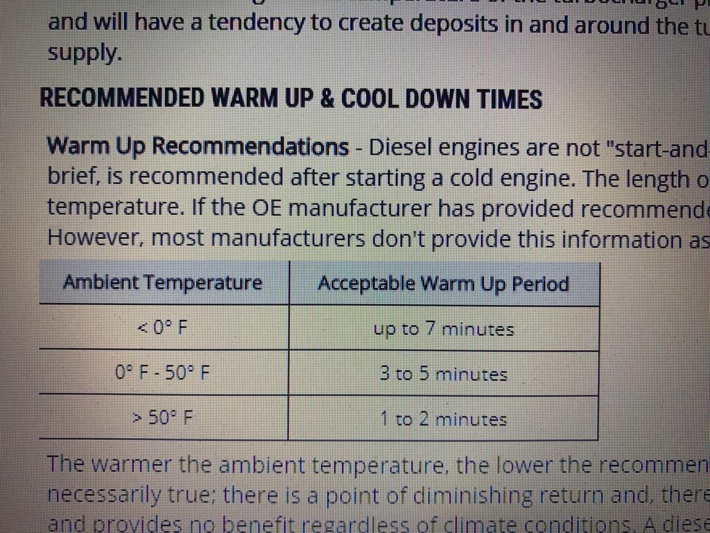

The article clearly says that unburned diesel can glaze the cylinders (walls) and create a coating that prevents rings from sealing when idling cold. I believe this is worse than any cold oil lube issues.

Butttttttttt....the article you linked states plainly that "Diesel engines are not start-and-go machines and therefore a warmup period, however brief, is recommended after starting a cold engine."
There is a difference in FACT and OPINION...looks like you are simply opining again.
