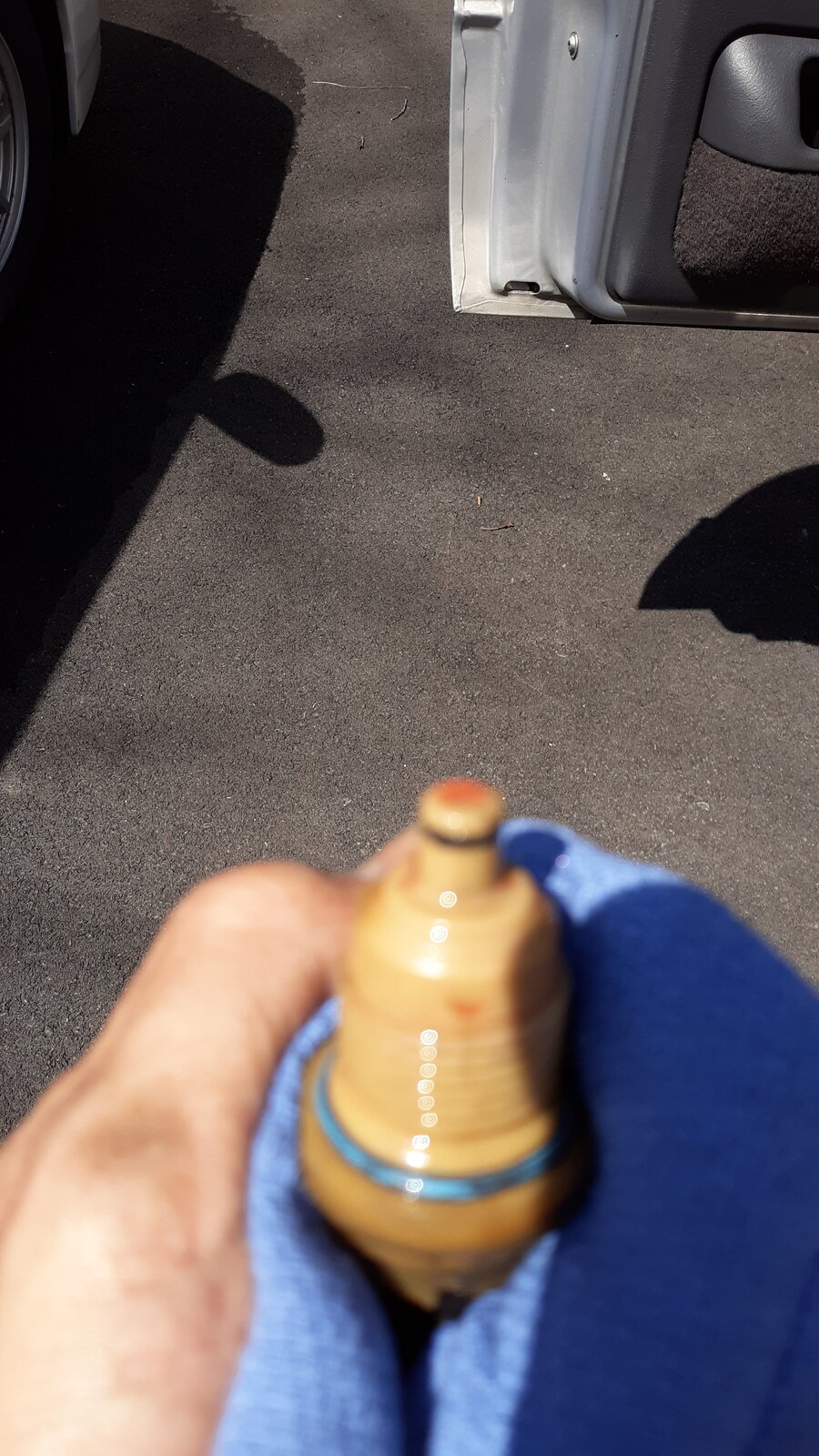

The sensor wasn't really very dirty. It did have a very little bit of material see picture. I was surprised that such a small amount would cause the situation. I cleaned, reinstalled and went for a test run.
Once on the highway the RPM fluctuations started again. I had to drive about 25 miles to the next exit so I stopped in town 3 times for a few things shutting truck down.
Was fully expecting the same deal as I entered the highway for home...miraculously the RPMs were rock solid all the way back 55, 65, 70. Pretty odd for sure but I'll take it.
Going to order a new sensor today.
