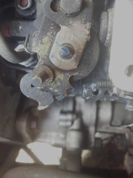

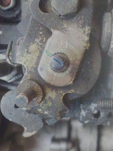

So I have been having lack of power issues with my truck for some time now. I can step on the accelerator and there is nothing there ( no guts at all) I can ease away from an interstcton and slowly build up speed but definitely no tire spinning power.
I had major problems with my transmission and just had it rebuilt thinking that the major slippage issues could be at fault... $1900.00 and WRONG.
so now I am down to the injection pump... the fuel lines are free and lift pump was just replaced (and has good fuel pressure)
A suggestion was made that the AFC diaphragm might have a leak in it so I decided to get a new one and replace it while I turn my fuel pin ;-)
The pin was a little difficult to get out but it finally came. There was a little dark red corrosion on the fuel pin and around the little pin that rides on it.
NOW FOR MY QUESTION:
It is my belief that the small pin in the injection pump that rides on the Fuel pin might be stuck in the recessed postion. Is this something that can be freed with minimal work or does the pump need to be torn down (out of my scope of knowledge)?
I was thinking of spraying something like wd-40 or carb cleaner in the hole amd working tgevpin back and forth to free it up then sucking the residue out.
Any ideas?
(Oh and i hydro tested my intercooler and lines to make sure there were not any boost leaks too)
