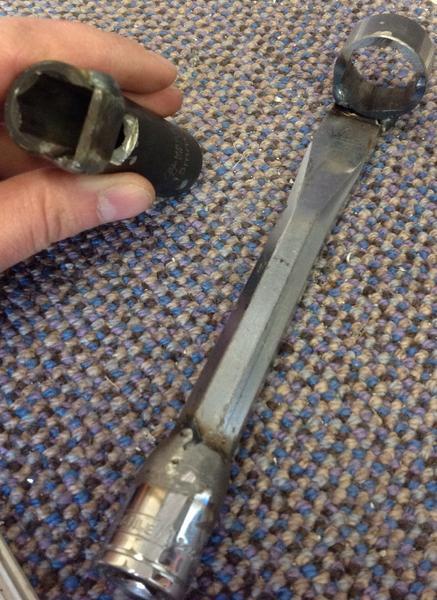

I created a crowfoot by cutting the end off a 15/16" socket and doing a little welding. Then I modified a 15mm socket to hold the injector in place. These tools got the #2 off. 3-6 came off real easy. The injectors on 2-6 pulled out very easily as well.
#1 broke the welds on both tools while trying to get the retaining nut off. The #1 injector has spun a little bit in the process, maybe an 1/8th of a turn. I'm still soaking the #1 with penetrant and getting ready to weld my custom sockets back together. I'll try again tonight. I was thinking about using some of that CRC Freeze-off and seeing how that does....
Probably not a bad idea to pull injectors at least once every ten years to keep this from happening, ugh.
The tools

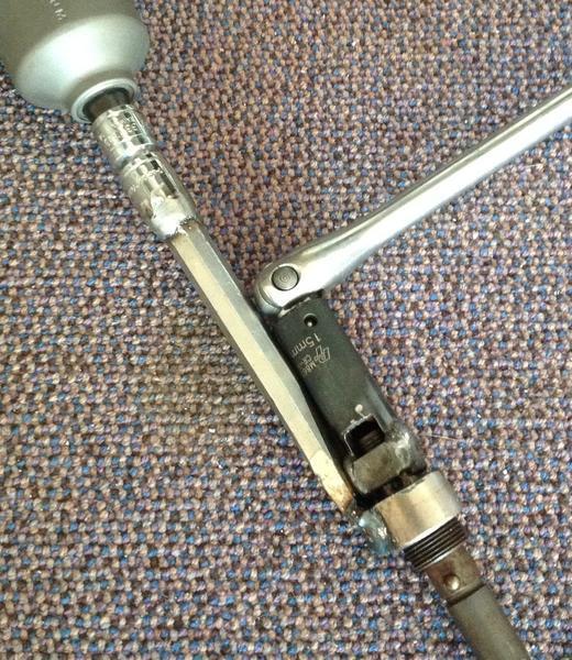

What it took: 5+ days of soaking in aerokroil, a lot of tapping, 5 attempts at breaking it free and failing, an old chisel, an old 15/16 socket, an old 5/8 socket, a 15mm impact socket, a piece of scrap metal, some welding, a breaker bar, an impact gun and a buddy.
Had my buddy hold the breaker bar to hold the injector in place while I slowly added air pressure to the impact gun till the nut broke free. Here's a pic of the set up.
