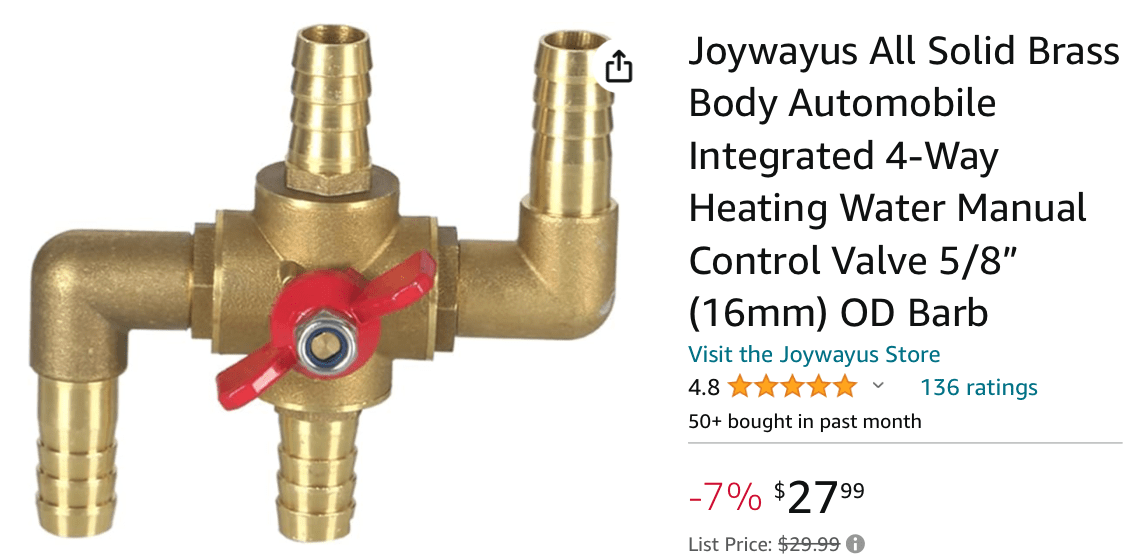

You fellows talking about tees and two valves are complicating things. The valve I referenced is all you need. When it's open, flow is through the heater core as it normally is. When you close it, the heater core is bypassed and coolant flow to the engine is normal. If you want to put it in the hoses, you're talking about four hose clamps. With tees and two valves you're talking 6-8 or more.
Exactly. Do just like Freightliner does and shut the line off that comes out of the cylinder head. That’s all that is needed.
You could use two T's in the line - one in the supply and one in the return. Put a ball valve in the supply line to the core, and one in the bypass line. Then the returns from both will go through the second T and back to the water pump. No need for valves in the return line.
That would work just fine. In fact, that provides the exact same functionality as the 4-port valves discussed above by BigPapa and myself, only more parts.
Seriously, just go with one of the 4-port valve assemblies. It will be much simpler, and if you go with the electric version, you can control it with a switch from inside the cab. Plus, it automatically prevents both valves being accidentally closed at the same time.
