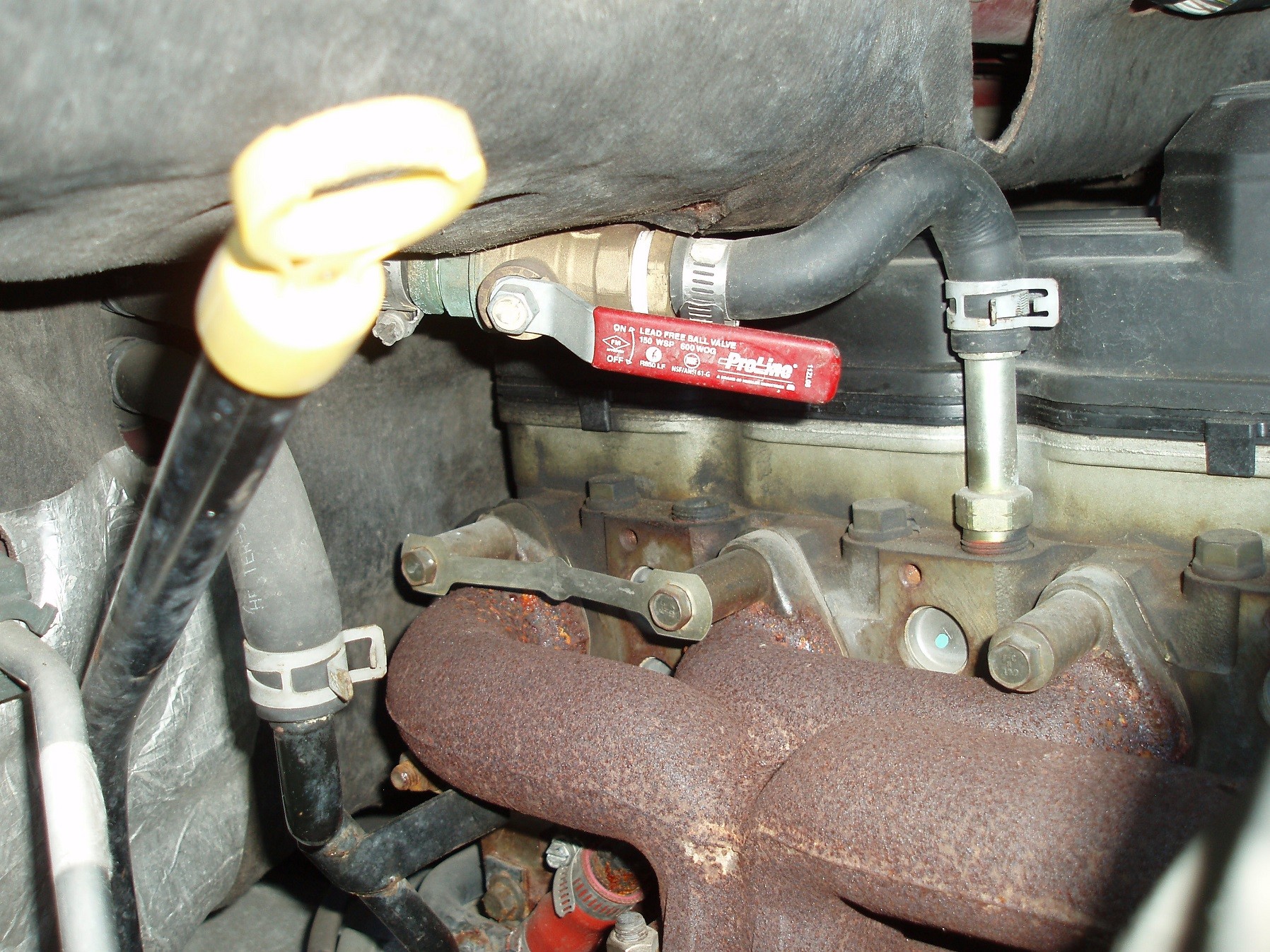

I’m not understanding the hate going on for someone to mod their truck. There have been lots of needless and crazy mods described on this forum over the years, but few I’ve seen so much strong disagreement from some of my most highly respected friends.
We’re talking about a simple cooling system mod, not about deleting emissions equipment. I’m specifically referring to my 12-valve, since I’m unfamiliar with the 3rd and 4th Gen systems. The use of a valve like I posted would not shut off any coolant flow except to the heater core. If you’re concerned with coolant stagnating in the core, open the valve up every once in a while and let it flooowwwwww….. If you’re concerned with leaks from numerous connections, how can you stand to drive a 4th Gen with all the y-pipes and, correct me if I’m wrong, even two radiators on some diesel pickups now?

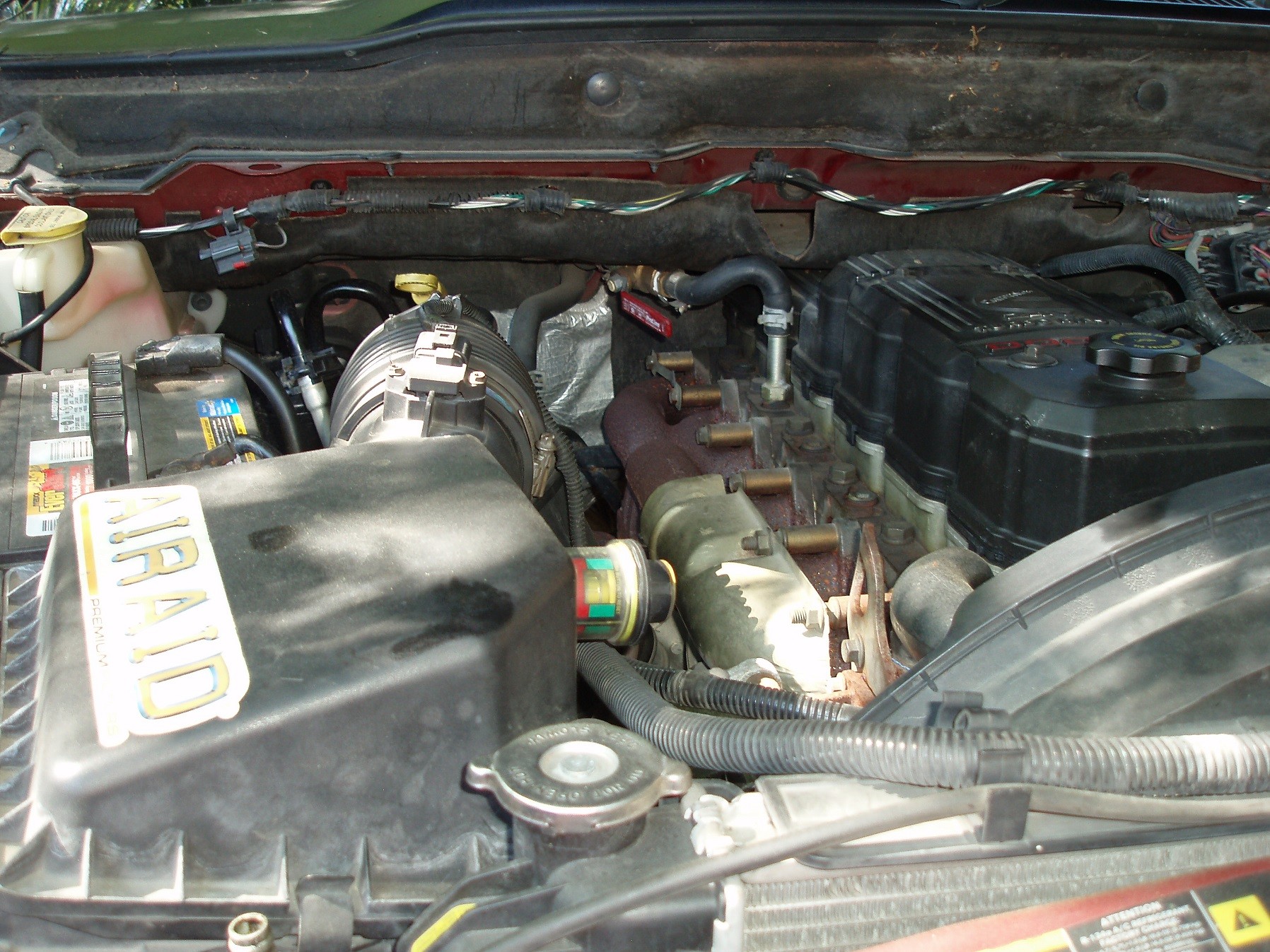

3rd gens are known to have a hot 5/6. The heater core flow comes from those cylinders, so if you block it off (or slow it down) you reduce flow to the rear of the block. At higher power and rpms that creates a potential issue that many have experienced.
This is why there are all kinds of mods to increase flow to the rear of the block and to reinforce the freeze plug.
So it’s not a hatred of a mod, but rather a recommendation to not complete a mod that reduces flow to 5/6 where there is a known concern.

The valve I posted would not restrict flow to anything but the heater core.

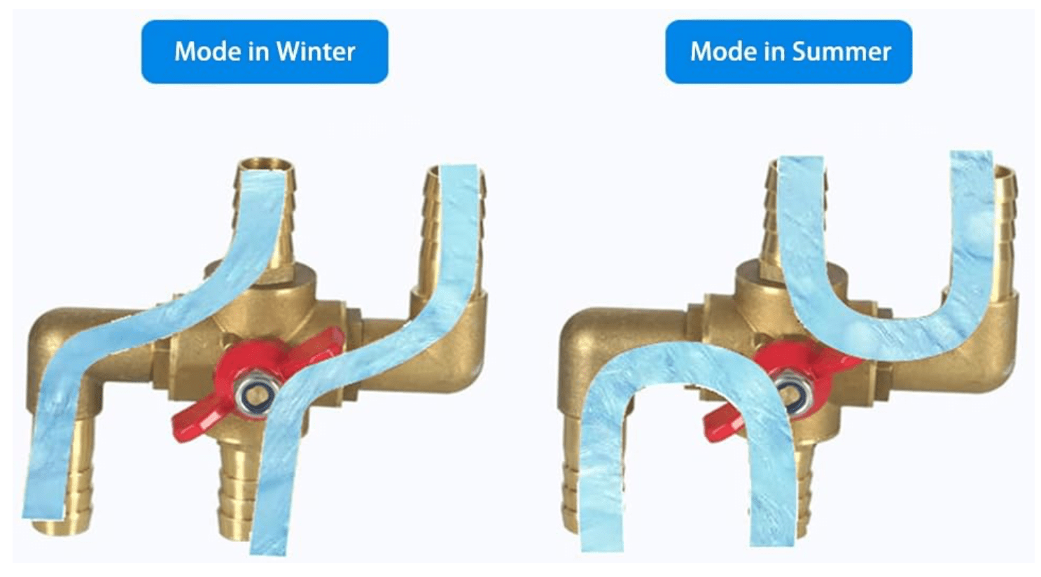

All of the valves I linked to above have the same flow pattern as shown for the valve BigPapa posted. What that means is all of these valves (4-port valves) maintain full flow from the head to the steel pipe regardless of the position of the valve. The coolant either all goes through the heater core and then into the steel pipe (bypass closed, winter mode), or all returns to the steel pipe, "bypassing" the the heater core (bypass open, summer mode), but STILL flowing. That's why they're called "heater core bypass valves" rather than "heater core shut-off valves" like Rowdy Dalton's setup. There is nothing to worry about regarding cylinders 5 & 6 with any of these 4-port bypass valves.
Yes, some older Chrysler/Plymouth/Dodge vehicles did employ a non-bypassing shut-off valve to improve A/C performance by also keeping hot coolant from flowing through the heater core depending on the motor that was installed, but those were not 4-port valves.
The Mopar system I discussed above works the same too. According to my research the vehicles that had these from the factory were set up so that they would fully bypass the heater core only when the air conditioning control was set to MAX.
It's just a knee-jerk "hatred" reaction going on, not understanding the flow of the 4-port bypass valve.

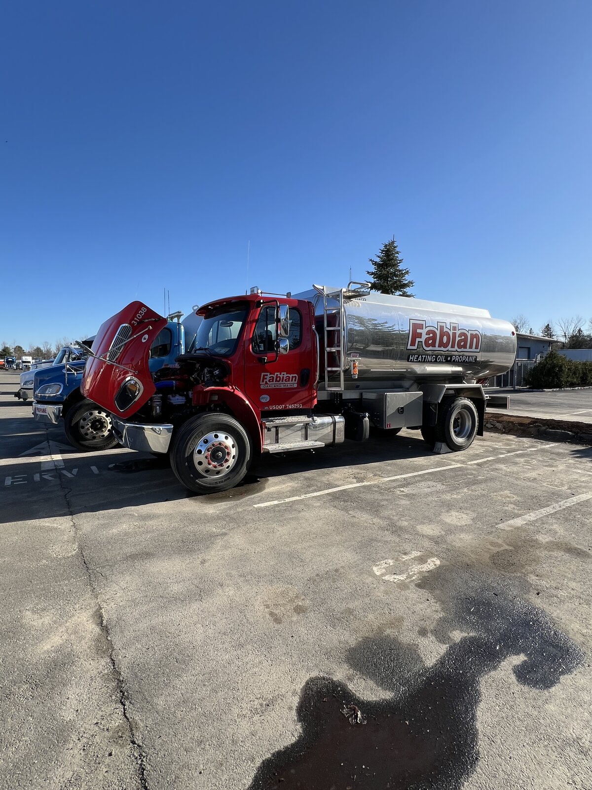

So here is a brand new Freightliner M2 on our lot that just rolled in from the upfitter..

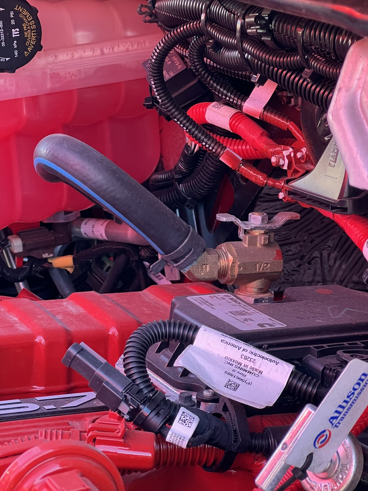

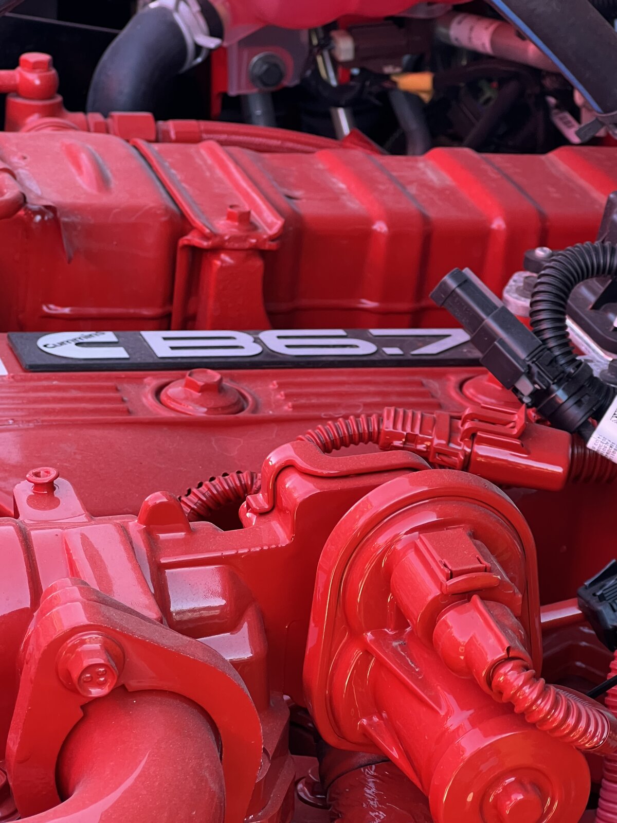

Notice engine make and nomenclature….and the dreaded valve…from the FACTORY!
Neither DTNA or Cummins would allow this if it caused any problems…they have done this for decades!! I can pop the hood on just about any Class 6 - 8 truck in this yard regardless of engine or truck make and there will be a set of shut offs for the heater core. This oil truck will see a lot harder duty cycle than most Rams..

The only 5.9 I know of with more hp and rpms than the HO in the Dodge is the QSB, which also runs a cooler thermostat so there is is likely much less on an issue on 5/6.

I notice that those valves on the Freightliner are manual. What does the operating manual say about when to close them? Are they there strictly for isolation, diagnosis and repair; or are they ever intended to be closed during steady-state normal use?

Way, way back before A/C was common in big trucks and heat from direct drive engine fans would literally roast a driver in the summer we used these valves to shut the water off to the heater core in hopes to drop the in cab temps just a bit…and also were very handy if the heater core was starting to leak and starting fogging the windshield…
The valves are now used to assist the A/C discharge temps in the summer and just like then will allow operation of the truck in the event of a blown heater core.
Truck cabs are better sealed and insulated than back in the day but shutting the water off to the heater core still makes a noticeable difference in summer time driving comfort.
