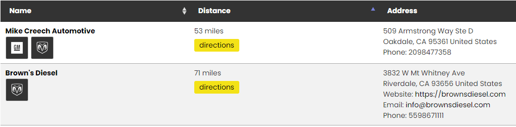

Goerend shows these installers in the area of Mariposa County, CA, in case you want to check them out. I know nothing about them, but if Goerend has them on their site, I'd say they're good.
Good leads and just fyi both of those are out of my county. Riverdale is Fresno County and about 80-90 miles which is not much further than the Fresno rebuilder I was honing in on so I will contact them. Oakdale might be Modesto County and is about 150 miles. I live in a beautiful mountain community but resources other than restaurants and motels are scarce. That's the way it is. I will call Browns and check reviews. Hopefully they work on little diesels.
