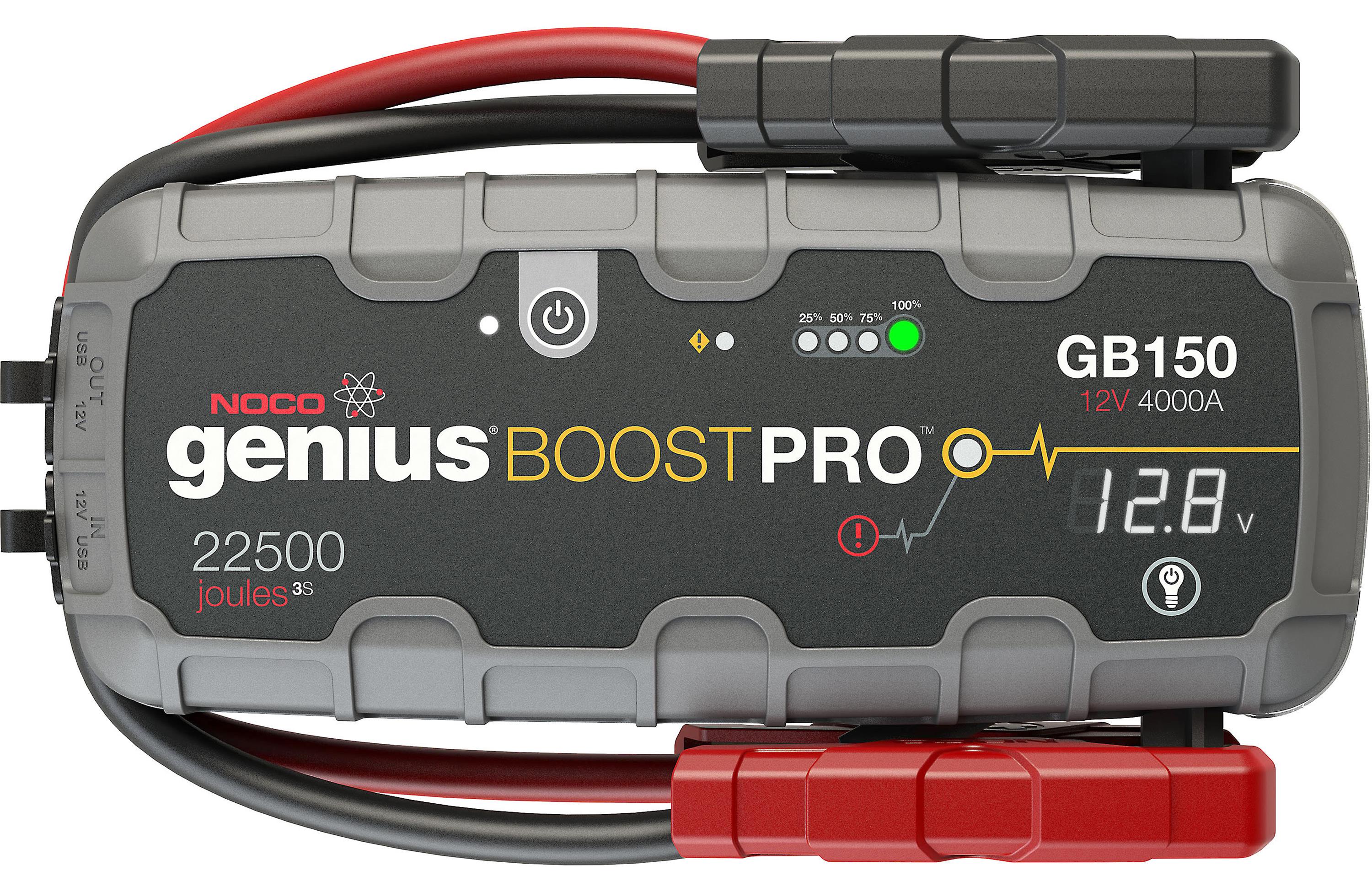

I have been looking for a jump starter solution and ran across this brand. I already use their smart chargers. It states it will jump a diesel up to 7.0.
https://no.co/gb150
This is listed on Amazon and now shows 4000 amp rating. I know the photos still show 3000 amp but a buddy recently purchased it off Amazon and sent me a photo and it is 4000 amp now. I also note the ad states it will jump up to 10L motors.
Amazon product ASIN B015TKSSB8
Does anyone have experience with this brand jump starter?
https://no.co/gb150
NOCO was mentioned in at least two other posts. Yes, I consider it a good brand.

Jump packs have came a looooong ways since early 2000's through, there are some out there that could jump start a dead Cummins.
Ahh, sorry about that. I should have looked at your link a little closer. Yes, same NOCO jump starter. Thanks for the confirmation.
