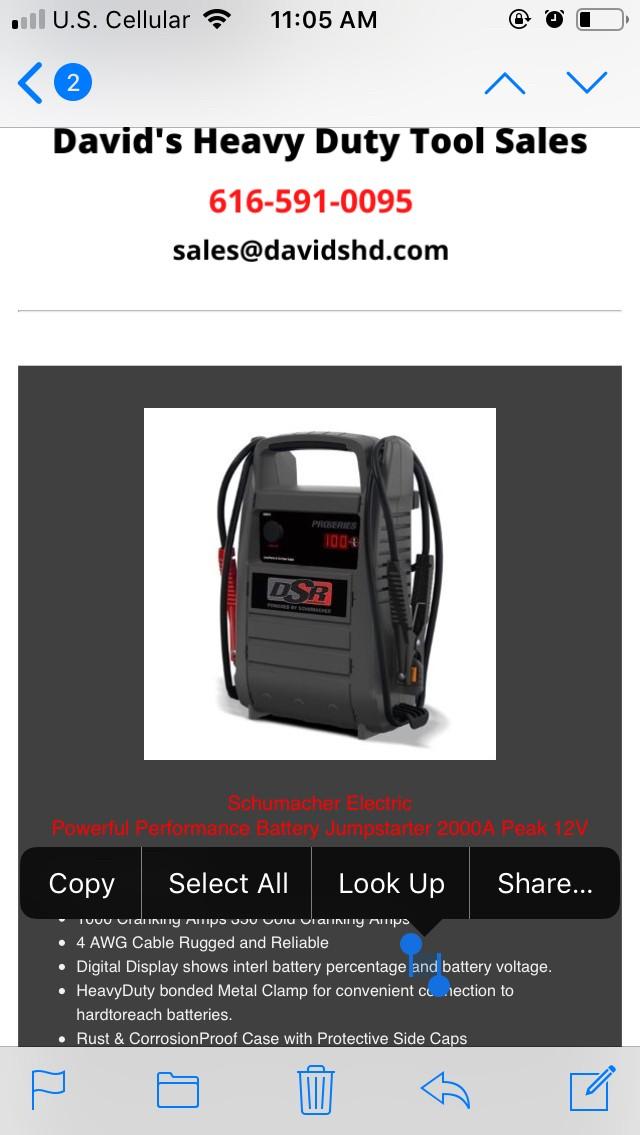

I got this in an email $160 from him right now thought that was a good price. I would assume decent quality since it’s Schumacher.
