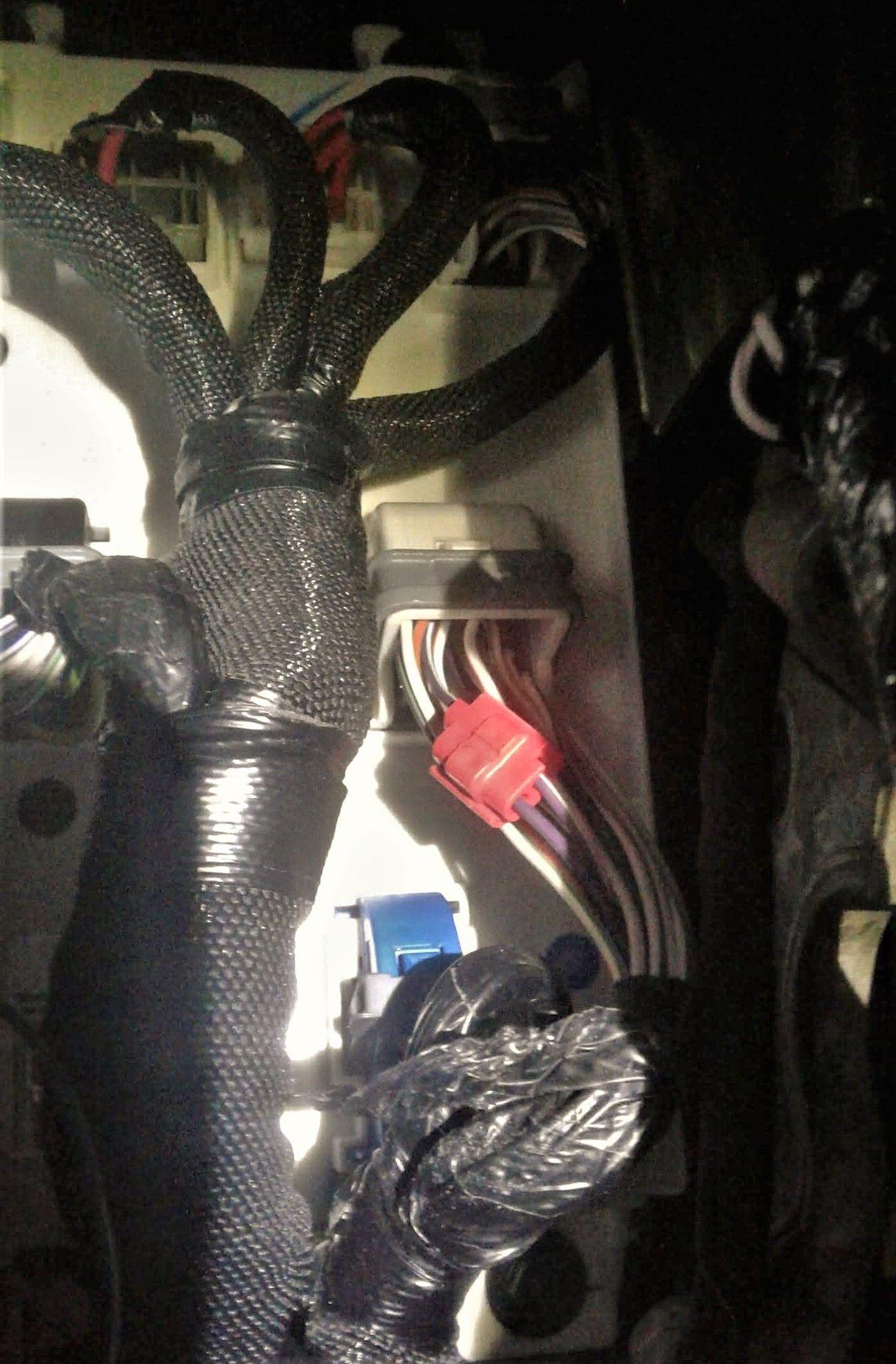

Just got a 2015 to replace my tired and rusted '03. Love it so far, and was able to silence the seatbelt chime, but the alert that my door is open while the key is still in the ignition is driving me crazy. I haven't been able to find a way to easily silence it. (yet)
I read somewhere of an owner that pulled apart his dash and instrument cluster and found the offensive little noisemaker, and silenced it for good. Problem with that is there are probably no chimes when something gets too hot or too low.
There seems to be some extra wires on the wiring diagram. The door ajar switches just have 1 wire, but for the return sensors, it shows a pair of wires. Not sure if the G and P numbers indicate where they go.
Wiring diagram shows the following connections to the Body Control Module:
Position 9 Violet DRIV DOOR AJAR G75
10 Tan/Brn DR LK SW RTN DRVR P371
23 Vio/Wht PAS DOOR AJAR SW SNS G74
24 Tan/Org DR LK SW RTN PASS P372
I'm thinking if I just clip the violet wire, it might be quiet, but it also dark-- No dome light. (or alarm?) I've thought about clipping it and splicing the driver switch in with passenger side violet and white, hoping it would just think the passenger door was the only one ever used. I'm not sure anything would work unless both doors were open.
HELP!
