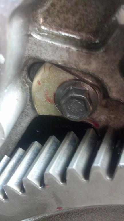

I recently (3 weeks ago) jammed a large stick up through my radiator while driving down an old logging path to retrieve my dads stuck tractor. So while I had the radiator out I figured it would be as good a time as any to pull the harmonic balancer and inspect it and pull the gear case cover and have a looksee. The dowel pin was in there and appeared to be tight but I decided to make a tab for it anyway. I simply used a 5/16 fender washer and whittled it down until it fit.
It's amazing what you can find laying around to fabricate a tab.
These dowel pins are like exploratory surgery. You're not sure what you'll find until you pull the gear case cover off. Mine looked exactly like the one above at 115,000 miles, and I also went ahead and tabbed it anyway. My nephew just picked up a '95 with 250,000 kilometers. He had the mechanic who was doing the safety, check the pin. His was ready to fall out. Go figure. He caught his just in time.
If I ever do another one, and find a loose one, I'll just try pulling it out with a pair of vise grips and be done with it. How often does anyone replace the gear case any way? If you have to, just get 2 long gear case bolts, cut the heads off, and use them as temporary pins.
I purchased a 98.5 Ram 2500 about 2 months ago with 88k miles on it. I just did the KDP inspection and fix. My pin was out about 1/16" and could be tapped-in about 1/8." I fabricated a shim out of a piece of old Toyota Prius battery cover. It had a hole for the nearby screw that was the right size.
