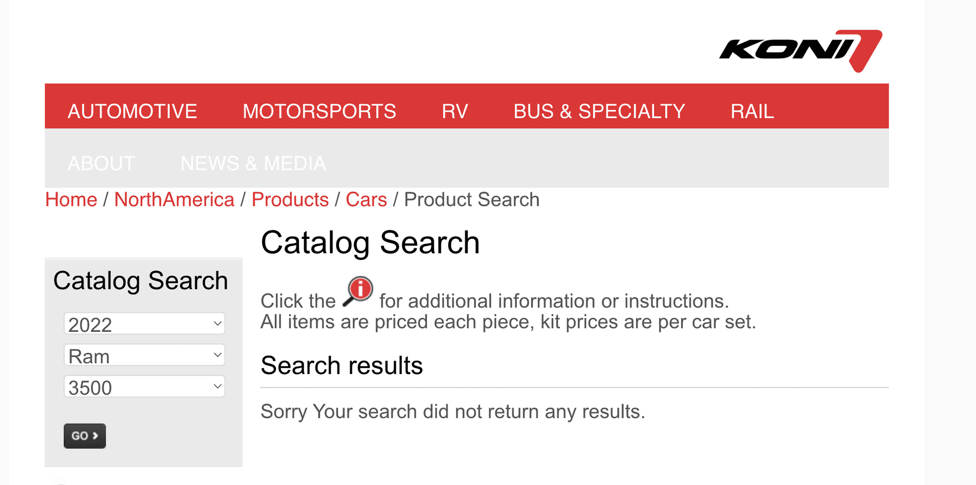

In the search to make my 2022 3500 regular cab long box haul my 3000 k truck camper with less slow speed side sway I came upon this . Expensive 4 shocks for $1400 then install labor. But a sway bar and shipping and install will be close to the same . Empty ride is supposed to be excellent. These are supposedly self adjusting shocks . Does anybody know anything about these shocks etc?
I cant find any Koni shocks listed for your trick...why dont you post a link to the actual shocks you are looking at.

Those are for 13-18 trucks, and excludes Air Suspension.
The Koni website doesn’t list any shocks for 19-23 trucks.
