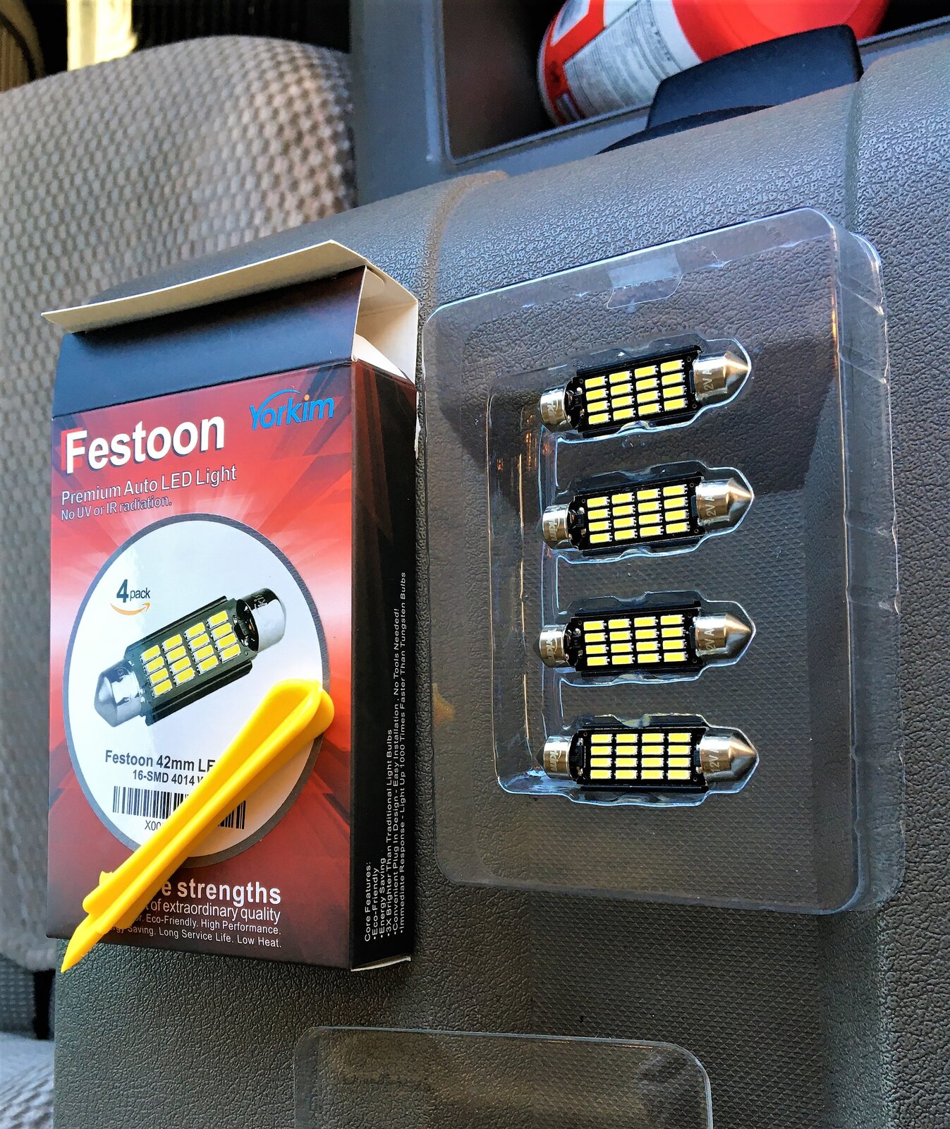

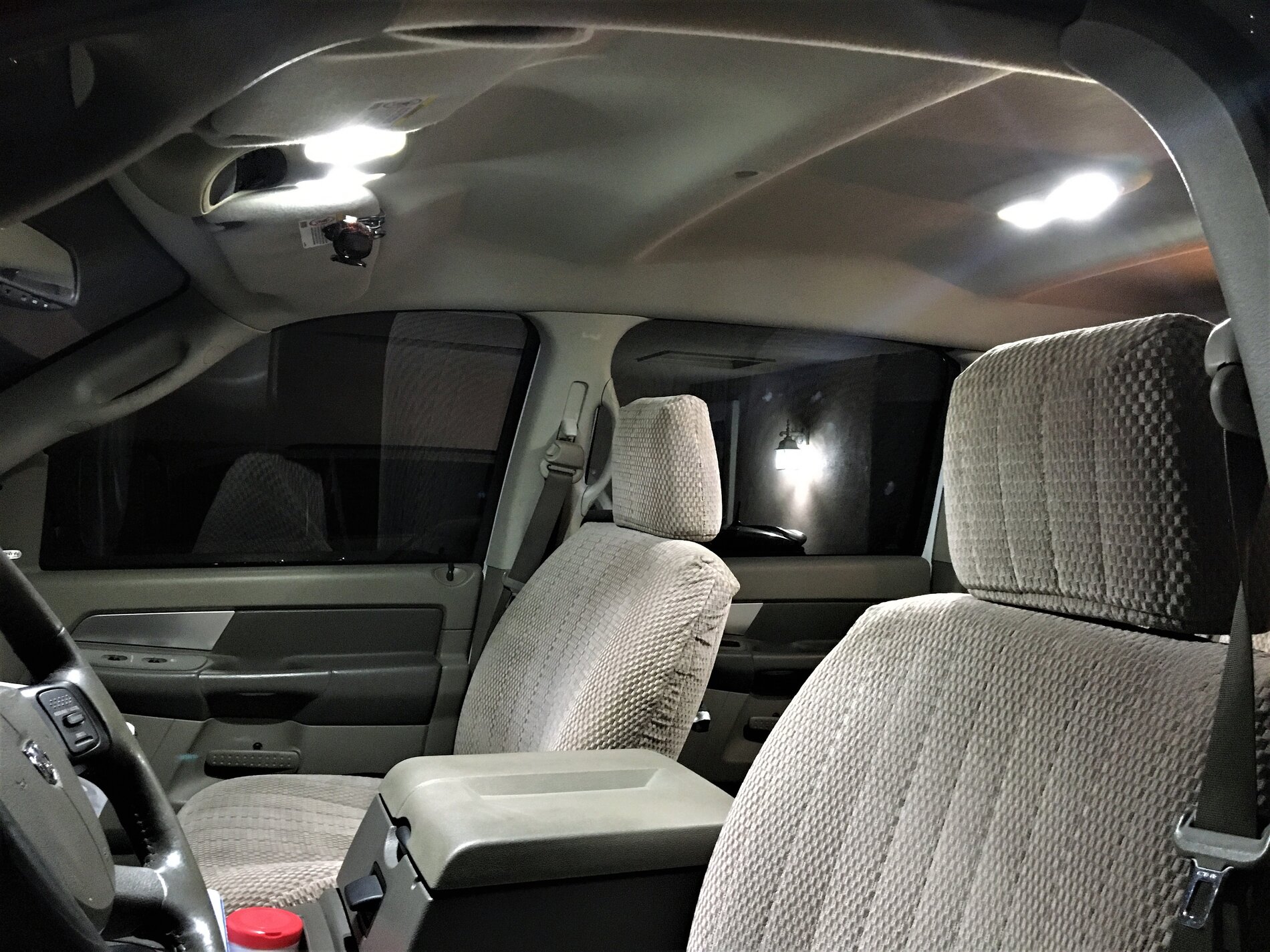

You might also think about upgrading the interior lights to LED, a big difference.
