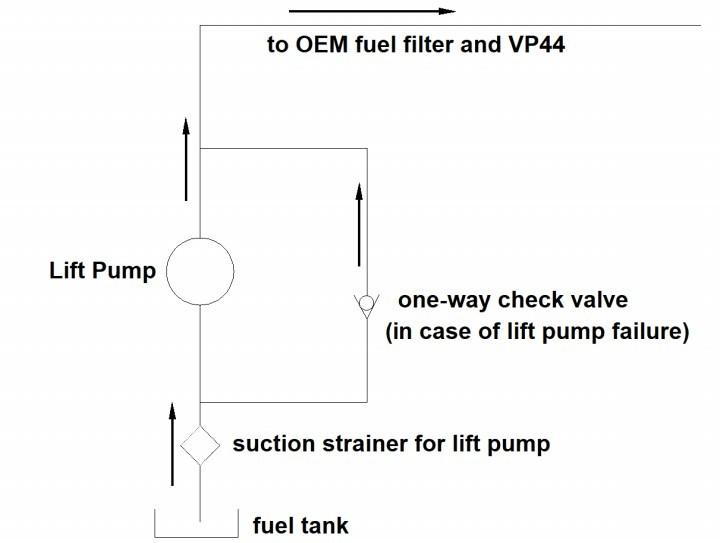

The Modification – This subject matter might be a bit controversial, but I believe I have found a good solution regarding driving a VP44 equipped truck when a lift pump has failed while on the road. After I did an experiment for checking fuel return volume from the VP44 fuel injection pump on my truck, I realized that I came upon what I believe to be a simple solution to one of the biggest fears for VP44 truck owners - a lift pump failure while on a road trip. For the experiment I routed a fuel line with a one-way check valve around the lift pump so fuel would still flow when the lift pump was non-operational (simulating an electric lift pump failure). The reason I say “fuel would still flow” is because the VP44’s internal vane pump will draw the fuel into the VP44 injection pump.
This lift pump bypass circuit includes a one-way check valve to flow fuel in a direction from the fuel tank to the stock filter housing. This lift pump bypass circuit on my truck is now a permanent circuit. Below is a diagram of the circuit.

Lift Pump Bypass Operation - During normal lift pump operation, the one-way check valve will not allow fuel to return to the suction side of the lift pump. A fuel pressure gauge at the inlet of the VP44 pump will always register a positive pressure.
With a lift pump failure, the fuel will pass through the free flow direction of the one-way check valve directing fuel around the lift pump into the VP44 pump inlet via the stock fuel filter housing. A fuel pressure gauge at the inlet of the VP44 pump will register zero at this time. There will actually be a small vacuum generated as the internal vane pump will be drawing fuel from the tank through the suction screen and fuel filter. What is important to note is that the same volume of fuel will be flowing through the VP44 injection pump and returning to the fuel tank as when the lift pump was operating.
I am not recommending or suggesting that anyone perform this modification to their truck. However; personally, I am very confident that this modification will cause no harm to the VP44 injection pump should a lift pump failure occur. In fact, I believe the bypass circuit offers more protection to the VP44 pump than a circuit without the bypass feature simply because a failed lift pump could block or severely restrict the fuel supply circuit.

Way back when (circa 2000) there was a lot of testing by members on this website to try and deal with the problematic lift pumps taking out the vp44s or perhaps better to say the seemingly high failure rate of the vp. Which there is no need to get into that now but one of the lingering questions even after all the testing then and up through even today is what kind of pressure does the vp need to keep it happy. While there have been revisions to the vp and the lift pump over the years since their introduction the general design is exactly the same. Dodge Ram truck is one of the few out of many uses for the engine with the vp44 that even uses a lift pump. The remainder of them just use the vp's low pressure pump to draw the fuel. One of the really big differences between the Dodge application and the others is the distance the vp has to suck the fuel. IIRC Dodge is the one who spec'd the lift pump not Cummins.
Many feel that the vp needs at least 10psi and preferably more like 14-15psi. One of the big arguments for higher pressure was to keep the vp cool as it is cooled by fuel. If you ran some flow tests you probably found that approximately 85+% of the fuel was returned to the tank. I have always felt that as long as it had some pressure (3-5psi) it would be ok. I certainly had my fair share of trouble with the VP44. In fact I went through 3 of them about 50k, 100k and 150k miles more or less. Each one seemed to last about 50ish k miles. The first two were taken out by or at least feel they were taken out by failed stock lift pumps. the last one is still working just fine at 375k miles. When I put the last one in I redid the fuel pump with a RASP (engine driven type pump via a belt) after I did some subsequent modifications I ended up converting to the 12 valve style mechanical lift pump driven by a lobe on the cam (I upgraded the cam in the truck and it had a fuel pump lobe on it where as the stock cam did not) which also cleaned up the fuel plumbing substantially from the rasp. After that I never gave my lift pump another thought as those pumps are pretty bulletproof.

@BarryG, thank you for taking the time to reply. Also, I read some of your earlier posts (a few years ago) regarding a lift pump low pressure problem that was very difficult for you to diagnose. Just curious, what did you have to do to resolve that problem?
I did run several flow tests - with the lift pump running and without the lift pump running (bypassed). When compared, the results were always the same - 19 gph at idle and higher amounts at higher rpm and the volume returned was well over 70% of the volume entering the VP44 (70% is mentioned in the 2002 FSM). The return flow volume was the same at a specific engine rpm whether the lift pump was operating or not operating (bypassed).

A question: if the flow is the same with and without a functioning lift pump, is the lift pump needed?
The reason I ask is because a friend's '01 2500 is having fuel supply issues. Since my truck is still down and I've used his several times, I plan on doing the work to fix it for him. The lift pump was replaced quite a while ago and was relocated to the frame. The system loses prime when it sits very long and it "runs out of fuel" with about 3/8 of a tank left. Since I need to get into the tank and probably replace some hoses, can we eliminate the lift pump? I recall that someone did years ago but I couldn't find the thread.
LP is absolutely necessary as the VP will fail without it within a couple thousand miles.
It is important to maintain a positive head pressure at the inlet of the VP44 injection pump. There are many industrial applications where a fuel tank is placed above the inlet of the VP44. In these applications, a positive pressure to the VP44 will always be present, so a lift pump is not needed.
However, in a vehicle application such as a truck, there would never be a positive head pressure at the inlet of the VP44. In fact, there would be varying degrees of negative pressure that would be dictated by the condition of the fuel filter, the suction strainer in the fuel tank, the pitch of the vehicle, and the level of fuel in the fuel tank. Also, should any air be introduced into the fuel system, a hard start or a no start condition could occur. Should this happen, there would be no way to bleed air from the fuel system without a lift pump. So, as you can imagine, a lift pump is very necessary and very useful.
The primary duty of the VP44 internal vane pump is to supply a flow of fuel for the internal operating components (timing piston, fill chamber for high pressure radial piston pump, accumulator, etc) and to supply a volume of return fuel flow to the fuel tank via the overflow valve. I don't believe it was ever intended for the internal vane pump to draw fuel from a distant fuel tank that did not provide a positive pressure to the inlet of the VP44 pump.
