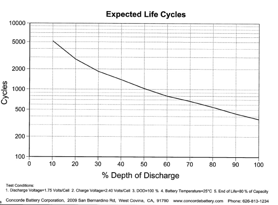

The same life reducing 100% DOD lead suffers appears to apply to the LiTime batteries. Marketing saying half the amp hours of lead is the same "price" when again I can get more out my lead batteries by trading off cycles. Yes, it's 4 times the life of lead at 50% DOD vs. LI at 100% DOD. However using only 40% of the Li battery 15,000 cycles... I don't use my RV that much. Lifeline also makes a LI battery now (IMO noncompetitive with a short warranty) however they mention expected life is 2000 cycles 100% DOD with 60% of battery capacity remaining. That 100 Ah is going to be 60 Ah when the battery is considered End Of Life worn out.
From LiTime's website.
AGM Lead from Lifetime's manual showing what happens to battery cycle life if I use 10%-100% DOD. It's NOT a direct comparison as lead is considered "worn out" at 80% of capacity in the chart below where Li gets 60% capacity.
