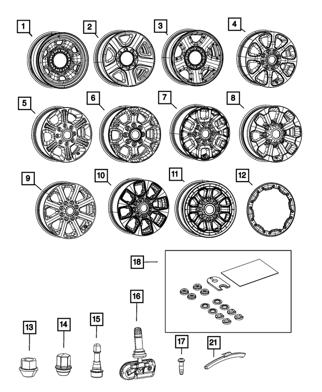

As soon as you have factory Aluminum wheels on a Gen4 - they don't fit over the Freespin Hubs. Only the basic steel rims fit.
So that leaves these kits more or less for the Tradesman trim level.

3rd gen Aluminum wheels will still clear. I'm using a factory 5 spoke set currently. Verify the hub bore required for the hubs before purchasing. Spyntec said only the factory 17" steelies would fit in the assembly manual but it may have been outdated at the time it was printed. There should be a measurement in the assembly manual for quick reference.

I think the New Gen 4 wheels will clear the hubs offered by RAM man . Ford has the same style wheel hub design on their new 250 and 350 trucks.

Looks like they will.

Since there was discussion on this thread about using 4+ gen wheels with lock out hubs ( freespin kits ) I've attached a graphic of current Mopar truck wheel offerings showing #1-3 with larger center bore wheels that should support such kits. I'm pretty sure #2 is unchromed wheel, #3 is chromed, no idea about #1. I'd be interested in offsets of wheels #1-3 if somebody knows or can determine with a look at the wheel stamping.
