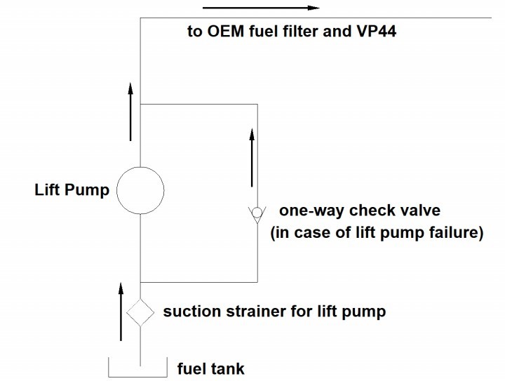

Something I forgot to add. I left my lift pump bypass fuel circuit in place in the event I have a lift pump failure. If that happens, the VP44 internal vane pump will continue to draw fuel from the tank and no harm will come to the VP44 injection pump. My low fuel pressure indicator lamp will light, but I will be able to continue driving. As hindsight, I should have installed this feature 20 years ago!
With what I have learned over the years and with a lift pump bypass circuit in place, and with the improvements Bosch has performed on the VP44, I now believe the VP44 fuel injection system is very reliable and will provide a long service life.

I am intrigued by the bypass check valve design that would prevent the VP44 from cavitating should an electric boost pump fail.
My RASP system has gauges that show me if the primary pump has failed which would be my signal to then activate the electric pump for continued reliable/safe/non-cavitation operation.
Yet, I like the simplicity of the check valve/bypass design which takes over automatically and provides a clear and unobstructed suction pathway for the VP44 to draw fuel in the event of a lift pump failure.
