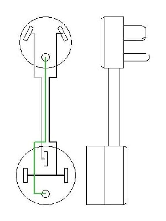

An RV doesn't have to be wired that way to use a 30 to 50 adapter. The 30 to 50 adapter powers BOTH buses in the 120/240VAC 50 amp RV's power distribution center. It does this by tieing the L1 and L2 leads of the 50 amp shore power cord together in the adapter. If you don't believe me, take an ohmmeter and ring out your 30 to 50 adapter. You'll find the single hot pole on the 30 amp side is connected to both hot leads on the 50 amp side. Here's a LINK to the info below if you want another source.
30-50 amp Dog Bone Adapter
We generally refer to some of these adapters as dog bones because the plug and receptacle at each end of a short piece of cable looks a little like a dog bone. Also instead of the long 50 amp Male to 30 amp Female description, we use a shorten format of the male amps first followed by the females amps.
In a 30-50amp adapter, the plug has two flat blades and the round prong. The Hot wire is used to attached to both Hot wires in the Adapter receptacle end along with the Neutral and the Ground.
This Adapter allows 50 amp style connections to a 30 amp power pole receptacle. Caution should be used because the 50 amp style connection could expect 100 amps of power (50 amps on each leg) and the outlet can only deliver 30 amps for both legs. The power pole breaker will protect the outlet.
The is probably the most used Adapter when 50 amp RVs visit older RV parks that have only 30 amp service.
